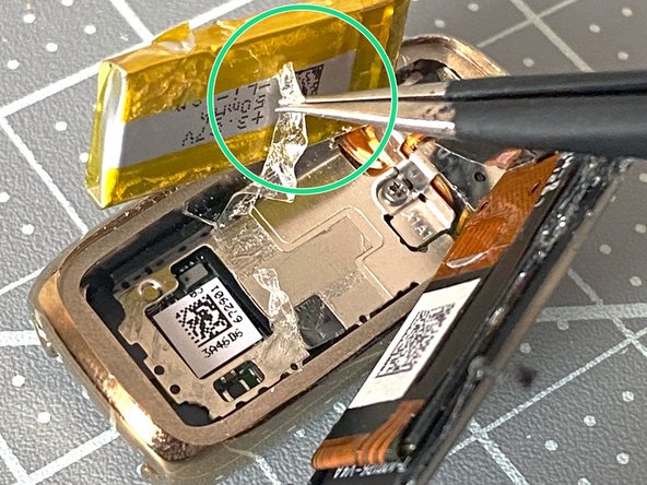

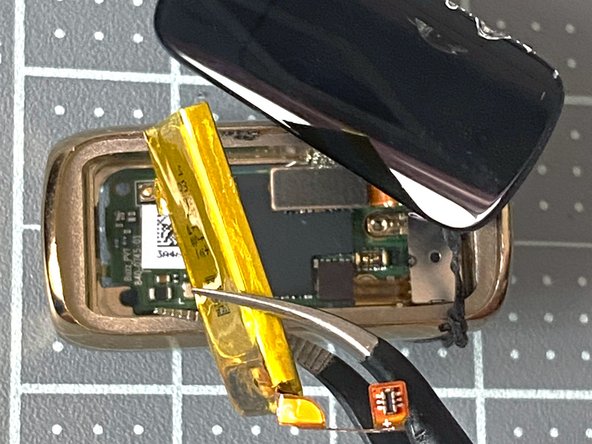

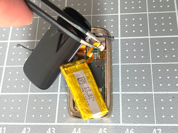

  3. Fitbit Luxe Teardown, Lifting the Screen and Battery: crwdns2935265:03crwdnd2935265:01crwdnd2935265:03crwdne2935265:0 Fitbit Luxe Teardown, Lifting the Screen and Battery: crwdns2935265:03crwdnd2935265:02crwdnd2935265:03crwdne2935265:0 Fitbit Luxe Teardown, Lifting the Screen and Battery: crwdns2935265:03crwdnd2935265:03crwdnd2935265:03crwdne2935265:0
    • Similar to the previous step, apply heat to the screen
    • Use a spudger, opening tool, or guitar pick to separate the screen from the housing
    • There may be glass shards if excessive force is used during prying
    • Use tweezers to lift the battery from the housing
    • Do not squeeze or pierce the battery
    • Use a Torx screwdriver to remove the center screw

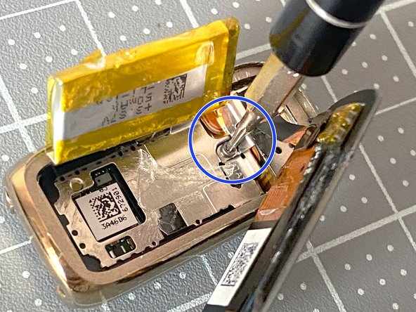

  4. Fitbit Luxe Teardown, Bracket Removal: crwdns2935265:04crwdnd2935265:01crwdnd2935265:03crwdne2935265:0 Fitbit Luxe Teardown, Bracket Removal: crwdns2935265:04crwdnd2935265:02crwdnd2935265:03crwdne2935265:0 Fitbit Luxe Teardown, Bracket Removal: crwdns2935265:04crwdnd2935265:03crwdnd2935265:03crwdne2935265:0
    • Use tweezer to remove the first bracket
    • Move the battery and screen to the side to provide better visibility
  5. Fitbit Luxe Teardown, Bracket Removal: crwdns2935265:05crwdnd2935265:01crwdnd2935265:02crwdne2935265:0 Fitbit Luxe Teardown, Bracket Removal: crwdns2935265:05crwdnd2935265:02crwdnd2935265:02crwdne2935265:0
    • Use tweezers to remove the underlying bracket
  6. Fitbit Luxe Teardown, Battery Removal: crwdns2935265:06crwdnd2935265:01crwdnd2935265:03crwdne2935265:0 Fitbit Luxe Teardown, Battery Removal: crwdns2935265:06crwdnd2935265:02crwdnd2935265:03crwdne2935265:0 Fitbit Luxe Teardown, Battery Removal: crwdns2935265:06crwdnd2935265:03crwdnd2935265:03crwdne2935265:0
    • Using tweezers, gently remove the battery's connector from the PCB
    • Lift the battery out of the assembly

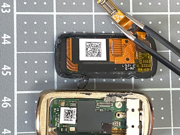

  7. Fitbit Luxe Teardown, Screen Removal: crwdns2935265:07crwdnd2935265:01crwdnd2935265:02crwdne2935265:0 Fitbit Luxe Teardown, Screen Removal: crwdns2935265:07crwdnd2935265:02crwdnd2935265:02crwdne2935265:0
    • Locate the screen's connector on the PCB
    • Using tweezers, gently remove the connector from the PCB

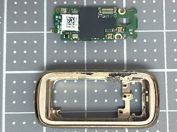

  9. Fitbit Luxe Teardown, PCB Removal: crwdns2935265:09crwdnd2935265:01crwdnd2935265:03crwdne2935265:0 Fitbit Luxe Teardown, PCB Removal: crwdns2935265:09crwdnd2935265:02crwdnd2935265:03crwdne2935265:0 Fitbit Luxe Teardown, PCB Removal: crwdns2935265:09crwdnd2935265:03crwdnd2935265:03crwdne2935265:0

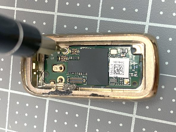

    • Use a Torx screwdriver to remove the two screws on the PCB
    • Use tweezers to remove the PCB from the housing

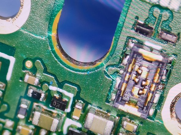

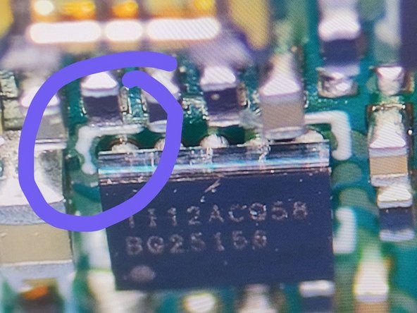

  11. Fitbit Luxe Teardown, Someones experience:: crwdns2935265:011crwdnd2935265:01crwdnd2935265:03crwdne2935265:0 Fitbit Luxe Teardown, Someones experience:: crwdns2935265:011crwdnd2935265:02crwdnd2935265:03crwdne2935265:0 Fitbit Luxe Teardown, Someones experience:: crwdns2935265:011crwdnd2935265:03crwdnd2935265:03crwdne2935265:0
    • Look for cracks, and board bents, especially near to the mounting holes (near the haptic feedback unit). My wifes luxe first stopped measuring, later started shutting down itself. When opened it I've found the battery very expanded, which have pressed the board outside and have cracked it, possibly tearing traces in the internal layers.

Do you have any tips on getting the screen off? I tried using my blow dryer for five minutes but it’s still in the casing
rhino_unease0o - crwdns2934203:0crwdne2934203:0
@calvinonofrei I believe it is Ambiq Apollo4 - an ARM Cortex M4 chip with 16 MB of RAM, which I am afraid woult not be a fit for any Wear OS
@rhinounease0o You need very thin metal plate to pry it off, because the gap between the screen and the frame is very tiny. Only hot air wasn't enough im my case. I have soaked it with IPA several times within an hour. this somehow softened the glue allowing me to slide the screen to one of the long sides and get the prying tool on the other long side. Otherwise the tool (0.15mm thick) was no go on either side of the screen. After you get it between the glass and the frame you can use a hair drier to heat it up and gently lift it.
