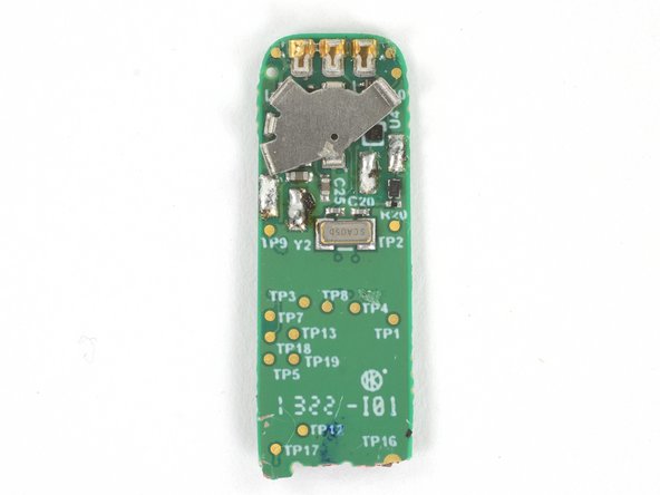

    • The motherboard flexes to show us what it's repping:
    • STMicroelectronics 32L151C6 Ultra Low Power ARM Cortex M3 Microcontroller
    • Nordic Semiconductor nRF8001 Bluetooth Low Energy Connectivity IC
    • STMicroelectronics LIS2DH 3-Axis Accelerometer
    • Charger IC: TI BQ24040

i also lost the cable charger, anybody know the 3 pin (positive negative) for fitbit. Any universal charger I can use?
Victor Hugo Garcia Hernandez - crwdns2934203:0crwdne2934203:0
look at the enlarged image... Left Pin is connected to the housing of the vibrator - this tells me its GND or Neg, center pin has a much thinner track on the PCB i would call it Data, right pin therefore looks like VCC+.
Sarah -
i also lost the cable charger, anybody know the 3 pin (positive negative) for fitbit. Any universal charger I can use and how?
Have you found out? Wish ifixit tore down the motherboard.
