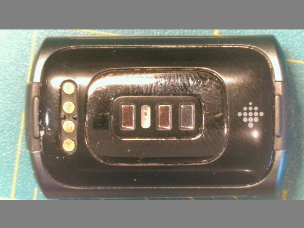

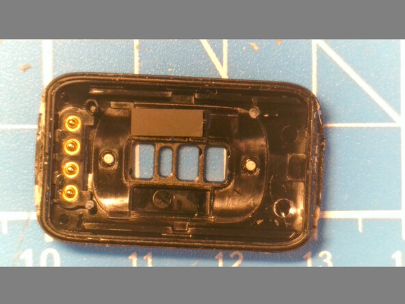

  2. Fitbit Charge 5 Teardown, Remove back: crwdns2935265:02crwdnd2935265:01crwdnd2935265:03crwdne2935265:0 Fitbit Charge 5 Teardown, Remove back: crwdns2935265:02crwdnd2935265:02crwdnd2935265:03crwdne2935265:0 Fitbit Charge 5 Teardown, Remove back: crwdns2935265:02crwdnd2935265:03crwdnd2935265:03crwdne2935265:0
    • Heat the back with a heat gun at 130C to loosen the adhesive.
    • Pry the side opposite the connector area from the strap latch
    • Pry the top and bottom near the connector. There are small plastic pins.

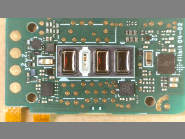

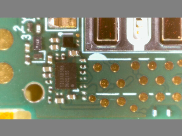

  3. Fitbit Charge 5 Teardown, On the back: crwdns2935265:03crwdnd2935265:01crwdnd2935265:03crwdne2935265:0 Fitbit Charge 5 Teardown, On the back: crwdns2935265:03crwdnd2935265:02crwdnd2935265:03crwdne2935265:0 Fitbit Charge 5 Teardown, On the back: crwdns2935265:03crwdnd2935265:03crwdnd2935265:03crwdne2935265:0
    • TI 14WP6JP AFE4500 - Texas Instruments Ultra-Small, Integrated AFE for Bio-Impedance Analysis, Electrical Biosensing and Optical Bio-sensing
    • TI13AD5R8 BQ25156 - Texas Instruments BQ25 series 1S battery charger
    • 121 2624 C72S - Unknown

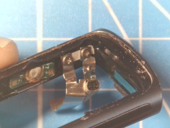

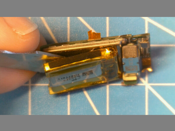

  4. Fitbit Charge 5 Teardown, Remove Main Board and Battery: crwdns2935265:04crwdnd2935265:01crwdnd2935265:03crwdne2935265:0 Fitbit Charge 5 Teardown, Remove Main Board and Battery: crwdns2935265:04crwdnd2935265:02crwdnd2935265:03crwdne2935265:0 Fitbit Charge 5 Teardown, Remove Main Board and Battery: crwdns2935265:04crwdnd2935265:03crwdnd2935265:03crwdne2935265:0
    • Pry from the sides of the battery to lift out. There is some adhesive/foam between the battery and case
    • You will have to cut the flex cables to the capacitive touch buttons on either side

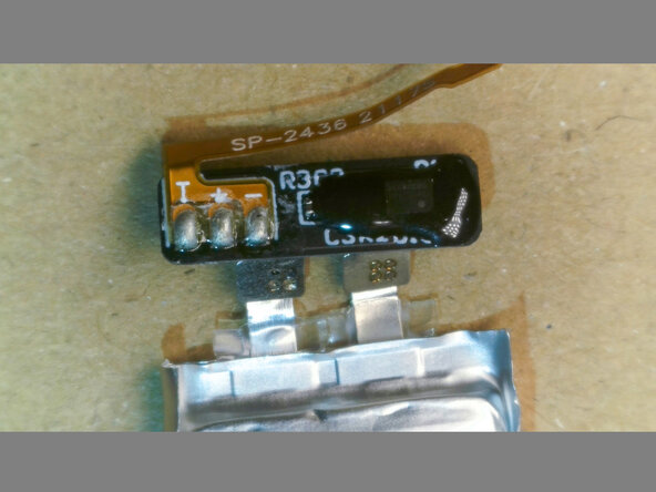

  5. Fitbit Charge 5 Teardown, Remove Battery: crwdns2935265:05crwdnd2935265:01crwdnd2935265:03crwdne2935265:0 Fitbit Charge 5 Teardown, Remove Battery: crwdns2935265:05crwdnd2935265:02crwdnd2935265:03crwdne2935265:0 Fitbit Charge 5 Teardown, Remove Battery: crwdns2935265:05crwdnd2935265:03crwdnd2935265:03crwdne2935265:0
    • Peel the battery off and unplug

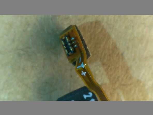

  6. Fitbit Charge 5 Teardown, Battery Detail: crwdns2935265:06crwdnd2935265:01crwdnd2935265:02crwdne2935265:0 Fitbit Charge 5 Teardown, Battery Detail: crwdns2935265:06crwdnd2935265:02crwdnd2935265:02crwdne2935265:0
    • 271617 unbranded battery. Marked as 65mAh
    • Mine tested at 24mAh, after a few years of use

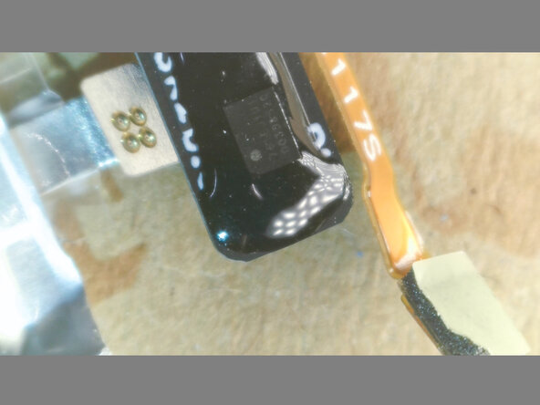

  7. Fitbit Charge 5 Teardown, Battery Protection: crwdns2935265:07crwdnd2935265:01crwdnd2935265:03crwdne2935265:0 Fitbit Charge 5 Teardown, Battery Protection: crwdns2935265:07crwdnd2935265:02crwdnd2935265:03crwdne2935265:0 Fitbit Charge 5 Teardown, Battery Protection: crwdns2935265:07crwdnd2935265:03crwdnd2935265:03crwdne2935265:0
    • 761EJ1U1 - Mitsumi MC3761 series protection IC with integrated MOS-FET for protection of the rechargeable Lithium-ion or Lithium-polymer battery
    • A temp sensor somewhere

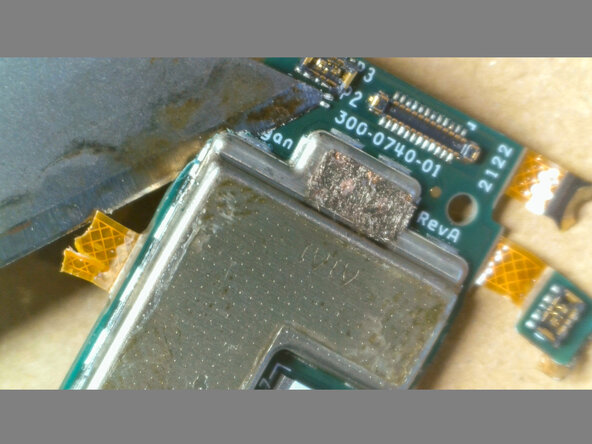

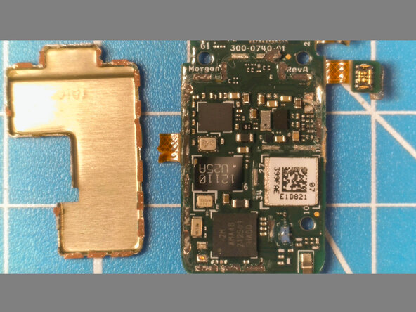

  8. Fitbit Charge 5 Teardown, Remove Can: crwdns2935265:08crwdnd2935265:01crwdnd2935265:03crwdne2935265:0 Fitbit Charge 5 Teardown, Remove Can: crwdns2935265:08crwdnd2935265:02crwdnd2935265:03crwdne2935265:0 Fitbit Charge 5 Teardown, Remove Can: crwdns2935265:08crwdnd2935265:03crwdnd2935265:03crwdne2935265:0
    • The can pops off easily with a razor blade starting at the corners
    • Hi Morgan 👋
  9. Fitbit Charge 5 Teardown, Mainboard Detail: crwdns2935265:09crwdnd2935265:01crwdnd2935265:03crwdne2935265:0 Fitbit Charge 5 Teardown, Mainboard Detail: crwdns2935265:09crwdnd2935265:02crwdnd2935265:03crwdne2935265:0 Fitbit Charge 5 Teardown, Mainboard Detail: crwdns2935265:09crwdnd2935265:03crwdnd2935265:03crwdne2935265:0
    • 2M AMA4B 212501 HADD - Ambiq Micro, Inc. Apollo4 Blue Lite SoC
    • QUAM V14 - Looks like a custom branded Fitbit chip
    • 12110 U25A - Unknown
    • NXP 100TB2 VC95122 037-080 - Unknown
    • Is this the GPS receiver? (if not, where is it?)
