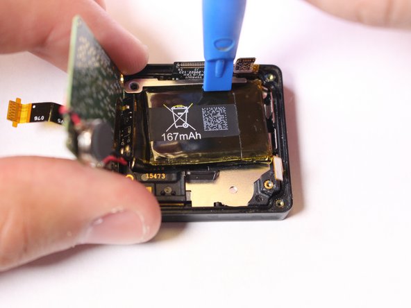

    5. Fitbit Blaze Motherboard Replacement: crwdns2935265:09crwdnd2935265:01crwdnd2935265:03crwdne2935265:0 Fitbit Blaze Motherboard Replacement: crwdns2935265:09crwdnd2935265:02crwdnd2935265:03crwdne2935265:0 Fitbit Blaze Motherboard Replacement: crwdns2935265:09crwdnd2935265:03crwdnd2935265:03crwdne2935265:0
      • Lift and push the motherboard to the side to uncover the 167mAh battery.
      • Use a plastic spudger tool to pry out the battery from its adhesive plastic underneath.
      • Lift up and pull downward to remove battery. Switch to the top portion of the battery and push downward to pry out battery.

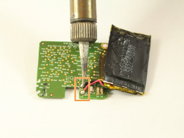

    6. Fitbit Blaze Motherboard Replacement: crwdns2935265:010crwdnd2935265:01crwdnd2935265:02crwdne2935265:0 Fitbit Blaze Motherboard Replacement: crwdns2935265:010crwdnd2935265:02crwdnd2935265:02crwdne2935265:0
      • Flip the motherboard to located the metal pins from the battery soldered to the board.
      • Desolder the connection to remove the battery component.
      • Follow this guide on how to solder and desolder connectors Soldering Guide
      • Excessive heat will damage the components, so do not apply the soldering iron to the component for long amounts of time.
