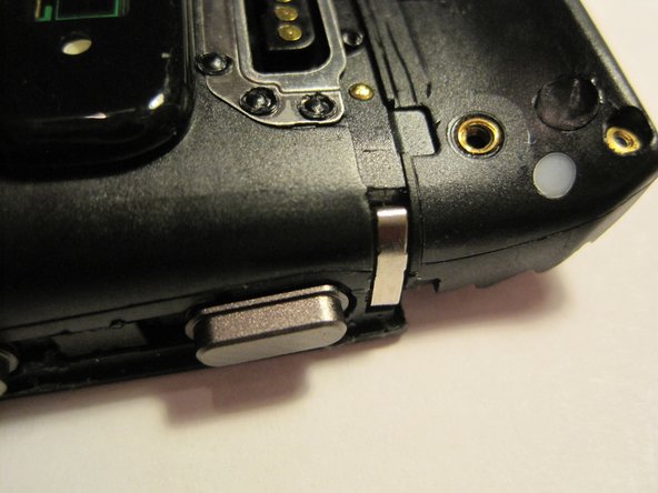

  5. FitBit Surge Teardown, Opening the body: crwdns2935265:05crwdnd2935265:01crwdnd2935265:03crwdne2935265:0 FitBit Surge Teardown, Opening the body: crwdns2935265:05crwdnd2935265:02crwdnd2935265:03crwdne2935265:0 FitBit Surge Teardown, Opening the body: crwdns2935265:05crwdnd2935265:03crwdnd2935265:03crwdne2935265:0
    • With the bands out of the way it's time to go inside Fitbit's guts
    • Remove the four metal parts as shown in the photo
    • After that just insert a screw driver or other sharp object into the fissure and voilá
