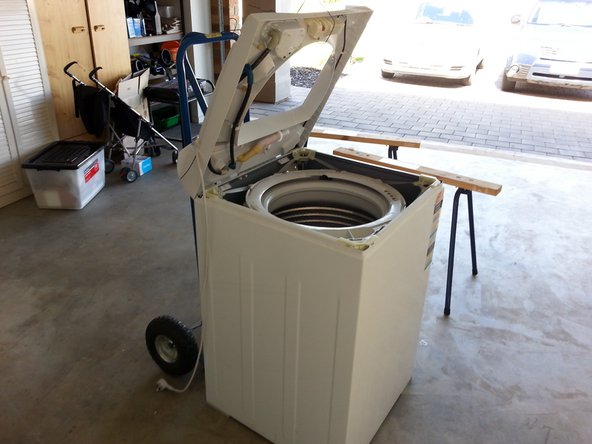

    • First step is to disconnect power.
    • Then disconnect all the hoses at the back and move the machine to a place where you have some room to work.

    • Simply pry off the plastic screw covers then unscrew the two forward screws. Note there is no need to remove the cover, just tilt it backwards on its hinge to gain access. Be careful with hoses and electrical wires at the back of the cover.
  4. Fisher and Paykel Aquasmart Washing Machine Suspension Rods Replacement, Suspend the cover out of the way: crwdns2935265:04crwdnd2935265:01crwdnd2935265:02crwdne2935265:0 Fisher and Paykel Aquasmart Washing Machine Suspension Rods Replacement, Suspend the cover out of the way: crwdns2935265:04crwdnd2935265:02crwdnd2935265:02crwdne2935265:0
    • I used an old coat hanger to suspend the plastic cover out of the way by hooking it onto the trolley that I used to move the washing machine. This gives you access to the 4 rubber straps and 4 suspension rods.

    • Once you have replaced all of the suspension rods and rubber straps you can reassemble the washing machine cover and lid. Then you are finished. My washing machine ran beautifully after I completed this repair. Best of luck to you.
