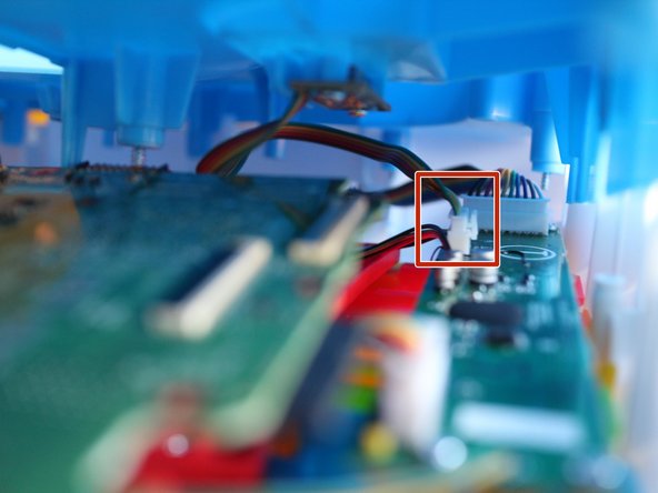

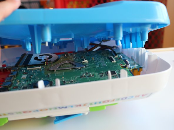

  4. Fisher Price Laugh and Learn  table Teardown [April Fools ...], Peeking inside: crwdns2935265:04crwdnd2935265:01crwdnd2935265:03crwdne2935265:0 Fisher Price Laugh and Learn  table Teardown [April Fools ...], Peeking inside: crwdns2935265:04crwdnd2935265:02crwdnd2935265:03crwdne2935265:0 Fisher Price Laugh and Learn  table Teardown [April Fools ...], Peeking inside: crwdns2935265:04crwdnd2935265:03crwdnd2935265:03crwdne2935265:0
    • After unscrewing 16 screws we can finally lift the bottom side
    • But be careful! There is a wire going from on/off switch that should be detached before removing it completely
    • The on/off switch wire connector

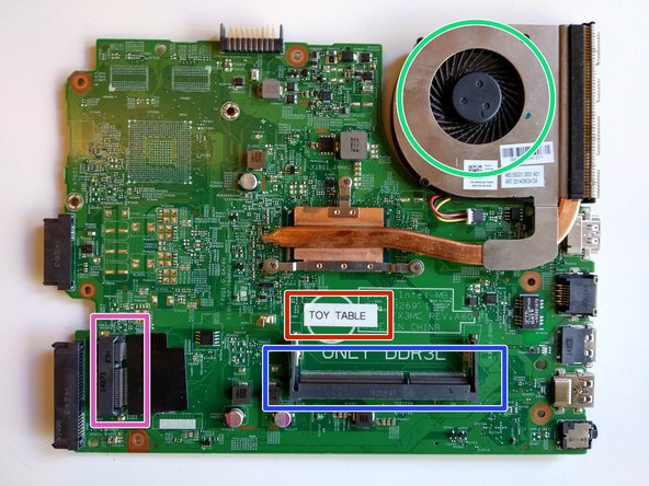

  5. Fisher Price Laugh and Learn  table Teardown [April Fools ...], The main board: crwdns2935265:05crwdnd2935265:01crwdnd2935265:03crwdne2935265:0 Fisher Price Laugh and Learn  table Teardown [April Fools ...], The main board: crwdns2935265:05crwdnd2935265:02crwdnd2935265:03crwdne2935265:0 Fisher Price Laugh and Learn  table Teardown [April Fools ...], The main board: crwdns2935265:05crwdnd2935265:03crwdnd2935265:03crwdne2935265:0
    • We love modular design!
    • The internal side of the main board features:
    • 60mm fan assembly with a single heat pipe and a tiny radiator
    • Authenticity label
    • Mini PCIe slot for wireless communication
    • DDR3 RAM slot, to buffer the audio effects

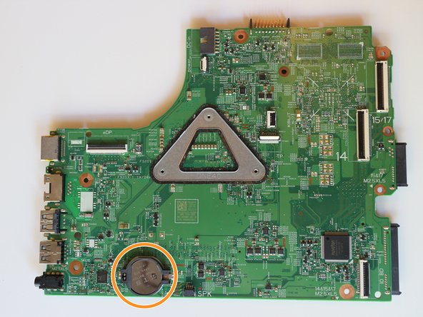

    • On the front side there is a tiny battery, that is probably used to back-up language settings

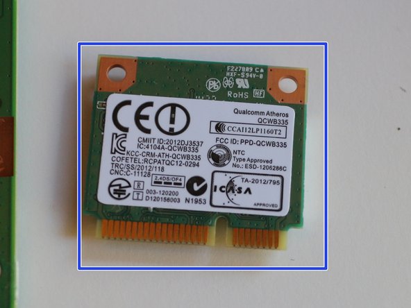

    • The wireless is powered by Qualcomm Atheros QCWB335 2.4GHz SB 1x1 Wi-Fi + BT 4.0
    • This is mid-2016 model. Nowadays mPCIe is obsolete, as all the major vendors use M.2 form factor.

Do you think it world be possible to pop the piano keys off to clean them underneath? My 1/red button is sticky and wears the batteries out really quickly
Catherine The Cool Mom - crwdns2934203:0crwdne2934203:0
Yes, it is possible. Switch the toy OFF. You need a long phillips screwdriver to reach all the 16 screws on the bottom. Disconnect the power wire when you lift the plastic - see photo in Step 4. Then carefully unscrew the little green board (see Step 5, on the right) and you’ll be able to remove and clean the buttons. Placing the buttons back might be a bit tricky. Good luck!
That was actually the reason why I took it apart - my kid was drooling on the piano and half of the keys stopped working :)
