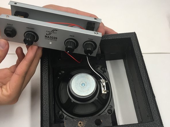

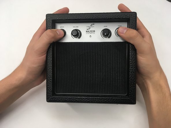

    • Next, set the MA2039 amplifier upright and begin unscrewing the four 25 mm screws with a #00 screwdriver.
    • Place your thumbs on the the input jack and the tone dial. While securing the back of the silver compartment with the rest of your hands, firmly push the silver panel out of place towards the backside of the amplifier.

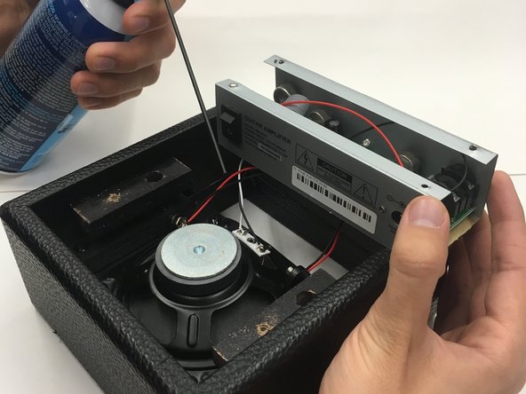

    • Thoroughly spray all parts of the amplifier.
    • Keep the nozzle of the compressed air at least 1 inch away from the part you are spraying.
    • WARNING: Do not inhale compressed air. While the name may lead people to believe it is just air the composition is heavier than air. Inhalation displaces the carbon dioxide in your system and can cause hypoxia and other negative side effects.
    • Extended use of canned compressed air can cause the can to be cold to the touch. Contact with the can could result in moderate frostbite. To prevent this from happening wear any type of gloves made of cloth or leather material and try to keep can upright at all times.

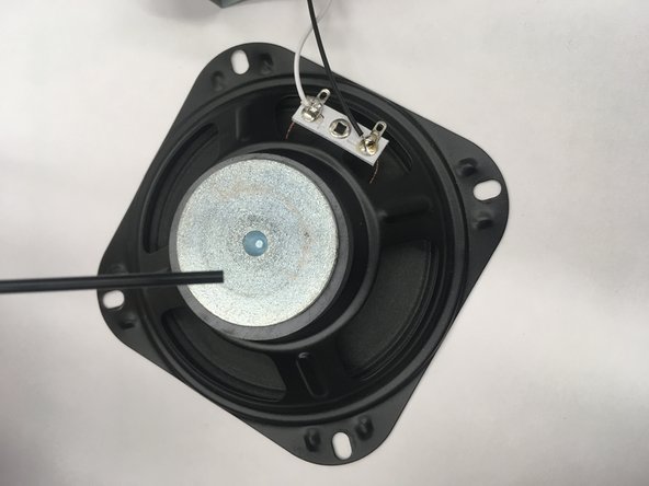

    • After dusting remove the subwoofer.
    • Begin by unscrewing the four 12 mm screws that are holding the subwoofer firm with a Phillips #00 screwdriver.
    • The subwoofer and silver compartment, while attached, will now be separable from the amplifier.
  6. First Act MA2039 Removing Dust: crwdns2935265:06crwdnd2935265:01crwdnd2935265:03crwdne2935265:0 First Act MA2039 Removing Dust: crwdns2935265:06crwdnd2935265:02crwdnd2935265:03crwdne2935265:0 First Act MA2039 Removing Dust: crwdns2935265:06crwdnd2935265:03crwdnd2935265:03crwdne2935265:0

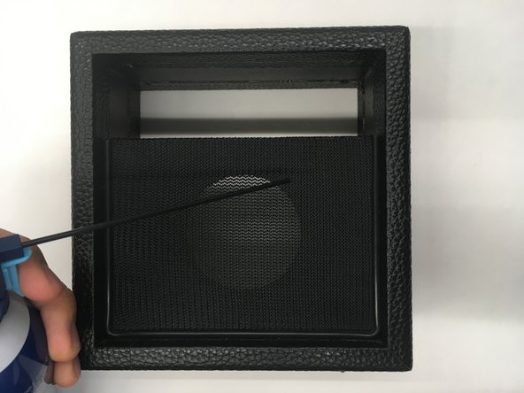

    • Spray the front and back of the subwoofer until clean of dust.
    • Spray the front and back of the black mesh located on the amplifier.
