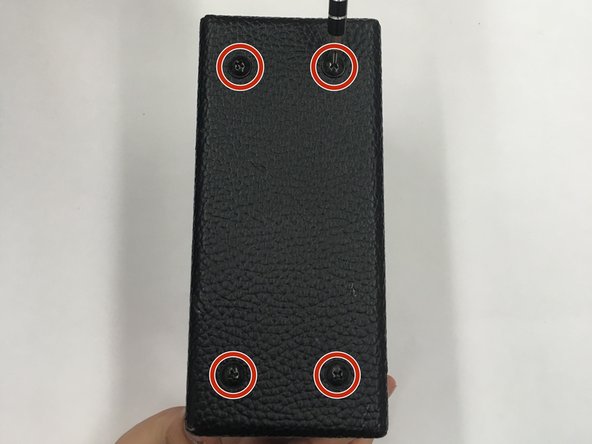

  3. First Act MA2039 Damaged Wire Replacement: crwdns2935265:03crwdnd2935265:01crwdnd2935265:03crwdne2935265:0 First Act MA2039 Damaged Wire Replacement: crwdns2935265:03crwdnd2935265:02crwdnd2935265:03crwdne2935265:0 First Act MA2039 Damaged Wire Replacement: crwdns2935265:03crwdnd2935265:03crwdnd2935265:03crwdne2935265:0
    • With the back panel off, this will help make space for the silver compartment to be removed.
    • Unscrew four 25 mm screws with a Phillips #0 screwdriver from the top of the amplifier.
    • Press firmly on the input jack and tone adjustment knob of the silver compartment to free it from its resting position.

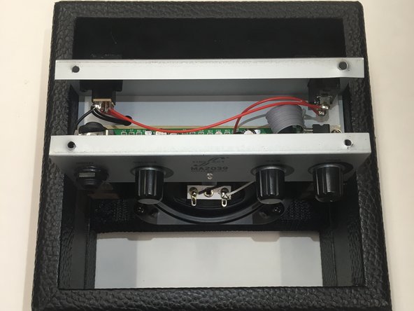

    • Rotate the silver compartment so that you have a clear visual of the motherboard and its components.
    • For effective work on the wiring, lodge the compartment on top of the back portion of the amplifier.
    • Check the wiring components for blown fuses or damaged connections.

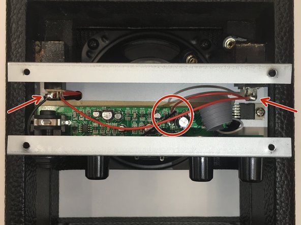

    • Lift the silver compartment to see where the wires are further connected.
    • Make sure that the terminals from the circuit to the amplifier are connected securely.
    • Check to see if there is loose wiring from the motherboard.
    • If there is damaged wire to the amplifier or motherboard in the silver compartment, refer this Soldering guide to replace wires and fix connections.
