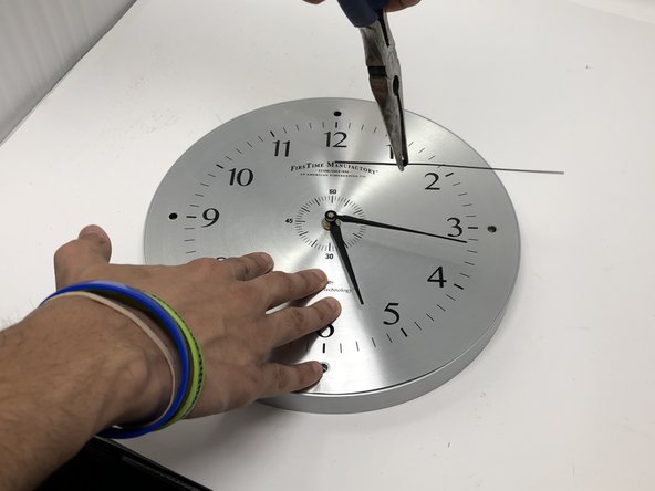

      • Turn the display face up.

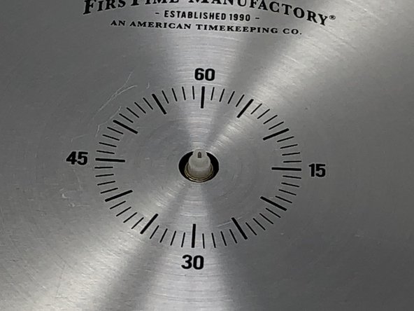

      • Use needle nose pliers to pull off the 'second' hand.

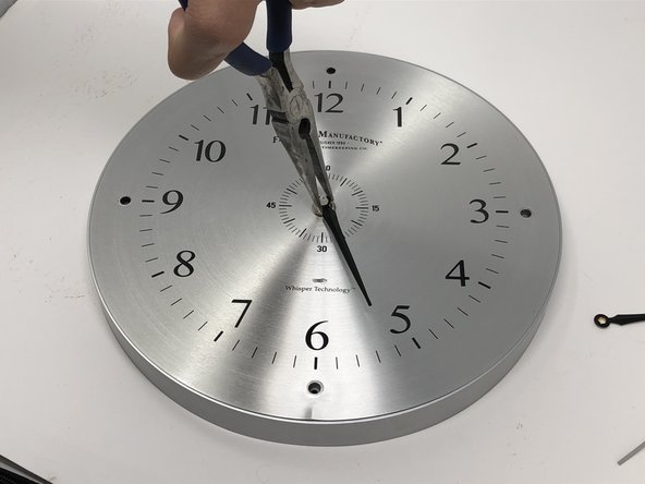

    4. FirsTime Wall Clock Movemement Mechanism  Replacement: crwdns2935265:04crwdnd2935265:01crwdnd2935265:02crwdne2935265:0 FirsTime Wall Clock Movemement Mechanism  Replacement: crwdns2935265:04crwdnd2935265:02crwdnd2935265:02crwdne2935265:0
      • Use needle nose pliers to remove the 'minute' hand.
      • Then use needle nose pliers to remove the 'hour' hand.
