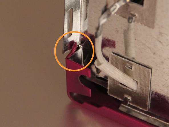

  3. Finelife NV-023172 2 Slice Toaster Teardown, A First Look Inside: crwdns2935265:03crwdnd2935265:01crwdnd2935265:03crwdne2935265:0 Finelife NV-023172 2 Slice Toaster Teardown, A First Look Inside: crwdns2935265:03crwdnd2935265:02crwdnd2935265:03crwdne2935265:0 Finelife NV-023172 2 Slice Toaster Teardown, A First Look Inside: crwdns2935265:03crwdnd2935265:03crwdnd2935265:03crwdne2935265:0
    • Remove the front and back plastic panels. 2 plastic slides hold the panels to the toaster. Slide the panels straight down, towards the toaster bottom.
    • Note: the front panel is held on with several wires. The wires have enough slack to remove the panel. Do not put excessive force on the wires or they may break at the connections inside the toaster.

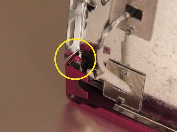

    • Locate the 4 tabs at the top corners of the toaster.
    • Bend the 4 tabs downward with the needle nose pliers to match the tab marked in yellow. Take care to not over stress the tabs and break them off.
  4. Finelife NV-023172 2 Slice Toaster Teardown, Full Case Removal: crwdns2935265:04crwdnd2935265:01crwdnd2935265:01crwdne2935265:0
    • One at a time, slide the metal side panels upwards and remove them from the toaster. The bottom flanges must be slightly bent outward to clear the toaster internals.
    • If the panels do not remove cleanly, double check that the tabs mentioned in Step 3 are clear of the other sheet metal parts in the toaster.

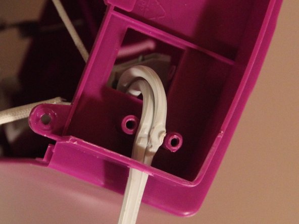

  6. Finelife NV-023172 2 Slice Toaster Teardown, Latch Mechanism and Strain Relief: crwdns2935265:06crwdnd2935265:01crwdnd2935265:03crwdne2935265:0 Finelife NV-023172 2 Slice Toaster Teardown, Latch Mechanism and Strain Relief: crwdns2935265:06crwdnd2935265:02crwdnd2935265:03crwdne2935265:0 Finelife NV-023172 2 Slice Toaster Teardown, Latch Mechanism and Strain Relief: crwdns2935265:06crwdnd2935265:03crwdnd2935265:03crwdne2935265:0
    • The latch mechanism contains:
    • A ferromagnetic piece that the electromagnet holds
    • An arm to close the power switch
    • A spring to launch toast in a vertical direction
    • Note: The latch mechanism can be removed by further bending the sheet metal. This is not advised as it may be very difficult to bend the sheet metal back to its original position during reassembly.
    • Pieces of electrical insulation board hold the wires. The heating elements are directly riveted to the boards and the boards are riveted to the sheet metal frame.
    • The strain relief can be removed by undoing 2 screws (blue). The screws have a special head type. They can be gripped with small needle nose pliers or wire cutters.
    • The strain relief cover comes straight off once the screws are removed
