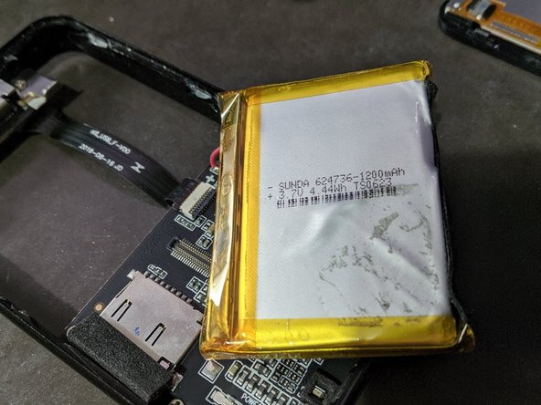

  6. Fiio M6 Teardown: crwdns2935265:07crwdnd2935265:01crwdnd2935265:01crwdne2935265:0
    • I removed the backplate, but for LCD or battery replacement is not necessary. The battery was glued to the back and there is an antenna on the top .
  7. Fiio M6 Teardown: crwdns2935265:08crwdnd2935265:01crwdnd2935265:02crwdne2935265:0 Fiio M6 Teardown: crwdns2935265:08crwdnd2935265:02crwdnd2935265:02crwdne2935265:0
    • Battery Detail.
    • Manufactured by SUNDA.
    • 3.7v to 4.2v
    • 1200mAh
    • 624736 pouch form factor
