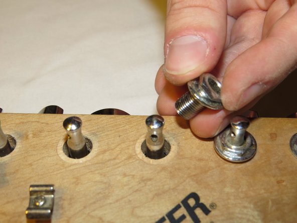

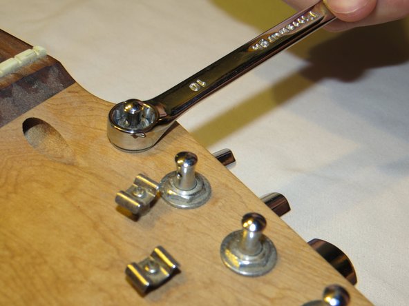

  4. Fender Starcaster Tuning Heads Replacement, Tuning Heads: crwdns2935265:04crwdnd2935265:01crwdnd2935265:02crwdne2935265:0 Fender Starcaster Tuning Heads Replacement, Tuning Heads: crwdns2935265:04crwdnd2935265:02crwdnd2935265:02crwdne2935265:0
    • Using a wrench, remove the nuts around each tuning head post.

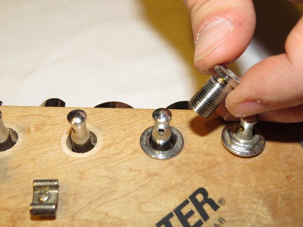

  5. Fender Starcaster Tuning Heads Replacement: crwdns2935265:05crwdnd2935265:01crwdnd2935265:03crwdne2935265:0 Fender Starcaster Tuning Heads Replacement: crwdns2935265:05crwdnd2935265:02crwdnd2935265:03crwdne2935265:0 Fender Starcaster Tuning Heads Replacement: crwdns2935265:05crwdnd2935265:03crwdnd2935265:03crwdne2935265:0
    • Next, remove the threaded retainer sleeve from each post.
    • Don't forget the washer.

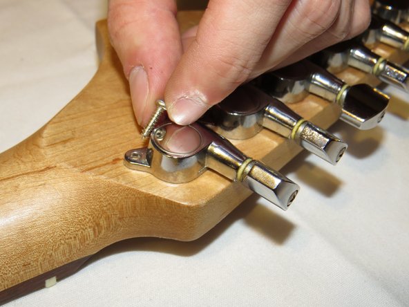

  6. Fender Starcaster Tuning Heads Replacement: crwdns2935265:06crwdnd2935265:01crwdnd2935265:02crwdne2935265:0 Fender Starcaster Tuning Heads Replacement: crwdns2935265:06crwdnd2935265:02crwdnd2935265:02crwdne2935265:0
    • Next, remove the screws from the backside of each tuner.

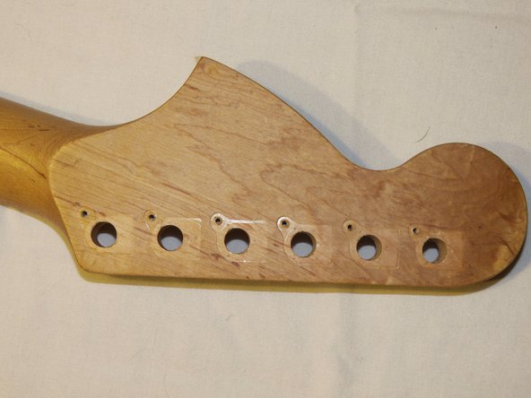

  7. Fender Starcaster Tuning Heads Replacement: crwdns2935265:07crwdnd2935265:01crwdnd2935265:02crwdne2935265:0 Fender Starcaster Tuning Heads Replacement: crwdns2935265:07crwdnd2935265:02crwdnd2935265:02crwdne2935265:0
    • Finally, remove the tuning machine assembly from the headstock.

Does the 2013 Starcaster take a 10mm tuning peg?
