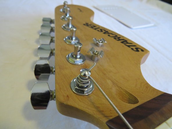

    1. Fender Starcaster String Replacement, Loosen the Strings: crwdns2935265:01crwdnd2935265:01crwdnd2935265:03crwdne2935265:0 Fender Starcaster String Replacement, Loosen the Strings: crwdns2935265:01crwdnd2935265:02crwdnd2935265:03crwdne2935265:0 Fender Starcaster String Replacement, Loosen the Strings: crwdns2935265:01crwdnd2935265:03crwdnd2935265:03crwdne2935265:0
      • Start by loosening the strings. This is done by turning the tuning knob until the string has lost tension.
      • Repeat this for all six strings on the guitar.

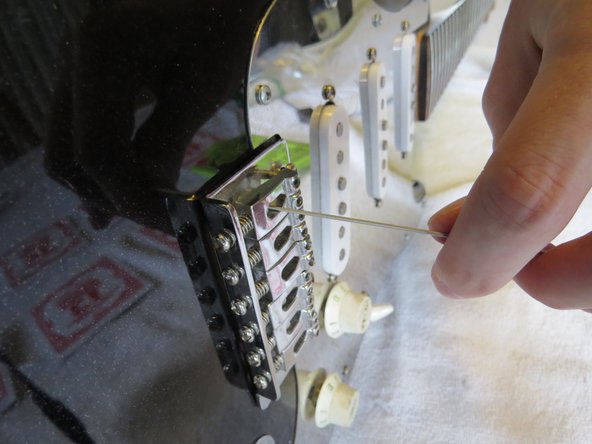

    3. Fender Starcaster String Replacement, Remove the Strings from the Bridge: crwdns2935265:03crwdnd2935265:01crwdnd2935265:03crwdne2935265:0 Fender Starcaster String Replacement, Remove the Strings from the Bridge: crwdns2935265:03crwdnd2935265:02crwdnd2935265:03crwdne2935265:0 Fender Starcaster String Replacement, Remove the Strings from the Bridge: crwdns2935265:03crwdnd2935265:03crwdnd2935265:03crwdne2935265:0
      • After removing the strings from the tuning pegs, slide the strings through the bridge and out of the back of the guitar.
      • If the twists in the string ends are in the way, use wire cutters to snip them off. This will allow the heavier strings to pass through the bridge easier.

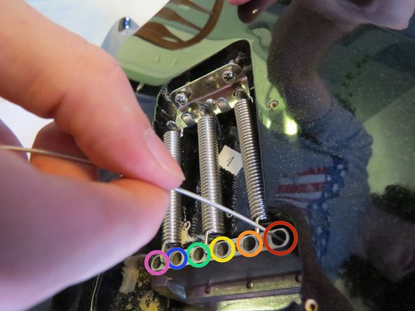

    1. Fender Starcaster String Replacement, String: crwdns2935265:04crwdnd2935265:01crwdnd2935265:03crwdne2935265:0 Fender Starcaster String Replacement, String: crwdns2935265:04crwdnd2935265:02crwdnd2935265:03crwdne2935265:0 Fender Starcaster String Replacement, String: crwdns2935265:04crwdnd2935265:03crwdnd2935265:03crwdne2935265:0
      • Take any one of the new strings and slide it through the appropriate bridge hole.
      • The replacement strings used on this guitar were "Regular Slinky" by Ernie Ball, which is a 10 gauge string set.
      • 6th String: E - 46 Gauge
      • 5th String: A - 36 Gauge
      • 4th String: D - 26 Gauge
      • 3rd String: G - 17 Gauge
      • 2nd String: B - 13 Gauge
      • 1st String: E - 10 Guage

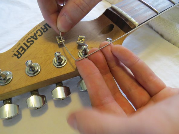

    2. Fender Starcaster String Replacement: crwdns2935265:05crwdnd2935265:01crwdnd2935265:03crwdne2935265:0 Fender Starcaster String Replacement: crwdns2935265:05crwdnd2935265:02crwdnd2935265:03crwdne2935265:0 Fender Starcaster String Replacement: crwdns2935265:05crwdnd2935265:03crwdnd2935265:03crwdne2935265:0
      • Lay the string parallel to the guitar's neck and directly over the appropriate tuning peg.
      • Measure a "three finger's length" (about 1.5") on the string passed the tuning peg.
      • Make a sharp bend in the string at where you measured 1.5" passed the tuning peg.
      • Turn the tuning peg until the string hole faces perpendicular to the guitar's neck.
      • Feed the bent string into the tuning peg until the bend meets the tuning post.

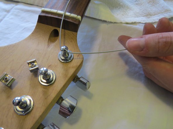

    3. Fender Starcaster String Replacement: crwdns2935265:06crwdnd2935265:01crwdnd2935265:03crwdne2935265:0 Fender Starcaster String Replacement: crwdns2935265:06crwdnd2935265:02crwdnd2935265:03crwdne2935265:0 Fender Starcaster String Replacement: crwdns2935265:06crwdnd2935265:03crwdnd2935265:03crwdne2935265:0
      • Make another sharp bend in the string on the outside of the tuning post.
      • Turn the tuning key counter clockwise while applying light pressure to the string on the inside of the post.
      • Wrapping the string around the post will help the string stay in-tune longer.
      • If the wraps of the string around the post start to roll over the top of the post, hold them down while still turning the post.
      • Continue turning the post until at least 2 full wraps of the string have been made around the post.
