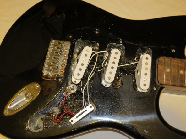

    • Gently lift up on the pickguard. With the screws removed, it should be loose, and easily pulled off of the guitar body.
    • Carefully rotate the pickguard away from the guitar. Notice the electronics. There is a wire that runs through the body to the output jack.

    • Now that the electronics have been freed, you may remove the pickguard.

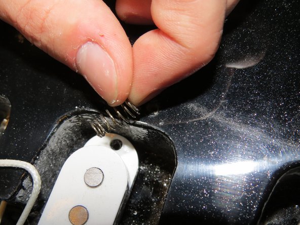

    • Be aware of the pickup retainer springs. These are to ensure that the pickup remains at a proper distance from the strings when it is attached to the pickguard.

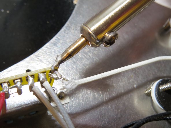

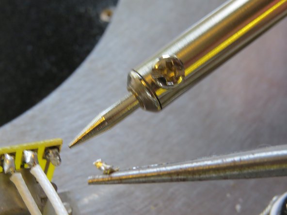

    • Heat up a pen-tip, soldering iron and lightly touch the solder on the end of the pickup wire.
    • Gently pull on the pickup wire while melting the solder.
    • After the wire is separated from the selector switch, remove any broken wire strands in the leftover solder with needle-nose pliers, while still heating the solder.

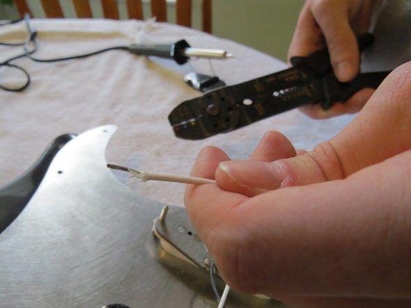

  12. Fender Starcaster Pickups Replacement, Strip New Pickup Wire: crwdns2935265:012crwdnd2935265:01crwdnd2935265:02crwdne2935265:0 Fender Starcaster Pickups Replacement, Strip New Pickup Wire: crwdns2935265:012crwdnd2935265:02crwdnd2935265:02crwdne2935265:0
    • Use wire cutters to strip about 1/2" of shielding off the wire.

    • Coat the tip of your soldering iron with new rosin core solder.
    • Heat the wire and coat the exposed pickup wire with a small amount of solder - thus "Tinning" the wire.
    • Melt the solder that is still on the selector switch terminal and quickly remove the excess solder from the terminal. Wrap the tinned wire around the terminal to make a good mechanical connection, before you solder.
    • Press the tip of the soldering iron onto the pickup wire and terminal. Add a little solder, until the solder melts and molds around the wire and terminal. Don't add too much solder (Solder Blob)!
    • Let the solder joint cool and become solid.
    • Lightly tug on the pickup wire to test the strength of the solder connection.
    • If the connection appears solid, reassemble the pickguard in reverse order.
