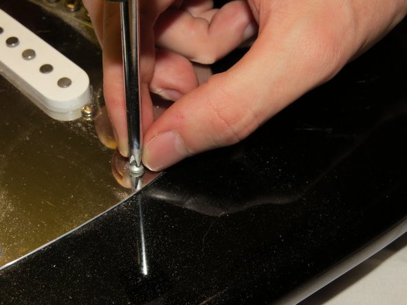

  6. Fender Starcaster Pickguard Removal: crwdns2935265:06crwdnd2935265:01crwdnd2935265:02crwdne2935265:0 Fender Starcaster Pickguard Removal: crwdns2935265:06crwdnd2935265:02crwdnd2935265:02crwdne2935265:0
    • Once the cap and knobs have been removed, you may begin removing the screws around the perimeter of the pickguard.
    • Do not remove the screws on the electronics.
  7. Fender Starcaster Pickguard Removal, Remove the Pickguard: crwdns2935265:07crwdnd2935265:01crwdnd2935265:03crwdne2935265:0 Fender Starcaster Pickguard Removal, Remove the Pickguard: crwdns2935265:07crwdnd2935265:02crwdnd2935265:03crwdne2935265:0 Fender Starcaster Pickguard Removal, Remove the Pickguard: crwdns2935265:07crwdnd2935265:03crwdnd2935265:03crwdne2935265:0
    • Gently lift up on the pickguard. With the screws removed, it should be loose, and easily pulled off of the guitar body.
    • Carefully rotate the pickguard away from the guitar. Notice the electronics. There is a wire that runs through the body to the output jack.
