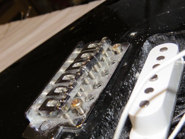

  3. Fender Starcaster Bridge Replacement, Remove the Strings from the Bridge: crwdns2935265:03crwdnd2935265:01crwdnd2935265:03crwdne2935265:0 Fender Starcaster Bridge Replacement, Remove the Strings from the Bridge: crwdns2935265:03crwdnd2935265:02crwdnd2935265:03crwdne2935265:0 Fender Starcaster Bridge Replacement, Remove the Strings from the Bridge: crwdns2935265:03crwdnd2935265:03crwdnd2935265:03crwdne2935265:0
    • After removing the strings from the tuning pegs, slide the strings through the bridge and out of the back of the guitar.
    • If the twists in the string ends are in the way, use wire cutters to snip them off. This will allow the heavier strings to pass through the bridge easier.

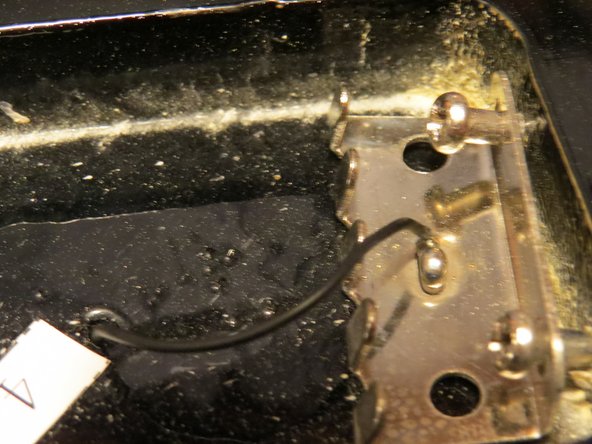

  4. Fender Starcaster Bridge Replacement, Bridge: crwdns2935265:04crwdnd2935265:01crwdnd2935265:02crwdne2935265:0 Fender Starcaster Bridge Replacement, Bridge: crwdns2935265:04crwdnd2935265:02crwdnd2935265:02crwdne2935265:0
    • On the back of the guitar, remove the plate covering the spring cavity. In the spring cavity, reduce the tension on the bridge springs by first loosening the retainer screws a bit.

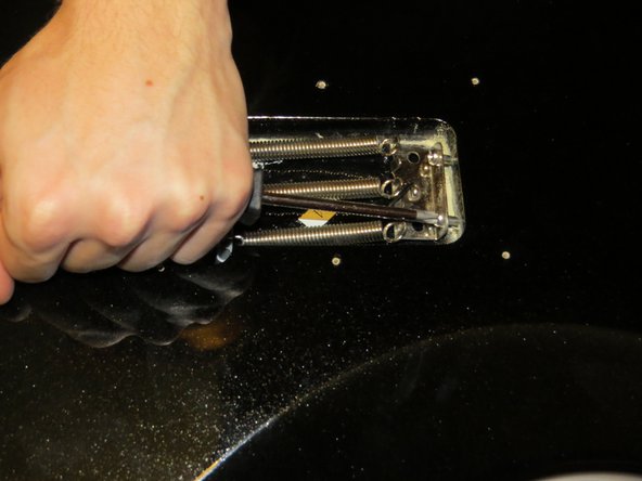

  5. Fender Starcaster Bridge Replacement: crwdns2935265:05crwdnd2935265:01crwdnd2935265:03crwdne2935265:0 Fender Starcaster Bridge Replacement: crwdns2935265:05crwdnd2935265:02crwdnd2935265:03crwdne2935265:0 Fender Starcaster Bridge Replacement: crwdns2935265:05crwdnd2935265:03crwdnd2935265:03crwdne2935265:0
    • To remove the springs from the bridge, grip the end with pliers and pull up.
    • It is safe to use the body of the guitar for leverage.

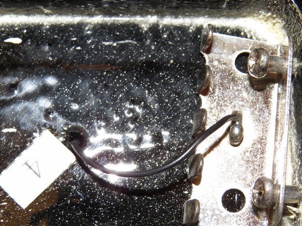

  6. Fender Starcaster Bridge Replacement: crwdns2935265:06crwdnd2935265:01crwdnd2935265:03crwdne2935265:0 Fender Starcaster Bridge Replacement: crwdns2935265:06crwdnd2935265:02crwdnd2935265:03crwdne2935265:0 Fender Starcaster Bridge Replacement: crwdns2935265:06crwdnd2935265:03crwdnd2935265:03crwdne2935265:0
    • Be aware that the ground wire for the electronics of the guitar is routed through the body and soldered to the spring retainer.

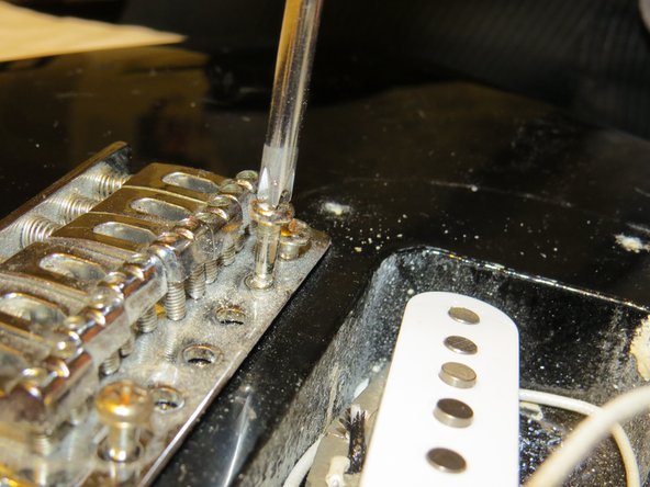

  7. Fender Starcaster Bridge Replacement: crwdns2935265:07crwdnd2935265:01crwdnd2935265:03crwdne2935265:0 Fender Starcaster Bridge Replacement: crwdns2935265:07crwdnd2935265:02crwdnd2935265:03crwdne2935265:0 Fender Starcaster Bridge Replacement: crwdns2935265:07crwdnd2935265:03crwdnd2935265:03crwdne2935265:0
    • Remove the screws from the front of the bridge.
    • It may be helpful to only loosen the outer screws as you remove the inner screws, in order to prevent damage to the guitar.
  8. Fender Starcaster Bridge Replacement: crwdns2935265:08crwdnd2935265:01crwdnd2935265:01crwdne2935265:0
    • With all six screws removed, lift up on the bridge to remove it from the body.
