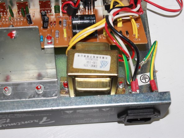

    1. Fender Frontman 15r Transformer Replacement, Transformer: crwdns2935265:08crwdnd2935265:01crwdnd2935265:02crwdne2935265:0 Fender Frontman 15r Transformer Replacement, Transformer: crwdns2935265:08crwdnd2935265:02crwdnd2935265:02crwdne2935265:0
      • Locate the transformer on the metal mounting bracket and be sure that it looks the same as the replacement that you plan on installing.

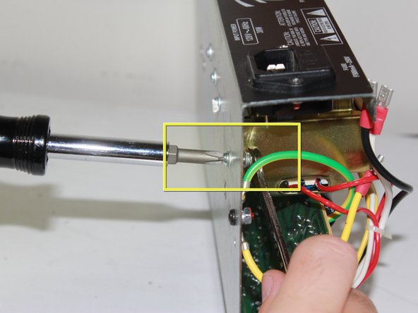

    2. Fender Frontman 15r Transformer Replacement: crwdns2935265:09crwdnd2935265:01crwdnd2935265:03crwdne2935265:0 Fender Frontman 15r Transformer Replacement: crwdns2935265:09crwdnd2935265:02crwdnd2935265:03crwdne2935265:0 Fender Frontman 15r Transformer Replacement: crwdns2935265:09crwdnd2935265:03crwdnd2935265:03crwdne2935265:0
      • Using a Philips #1 Screwdriver unscrew the two 14.8 mm screws connecting the transformer to the mounting bracket.
      • Hold the nuts in place while unscrewing the bolts using a 9/32" Crescent Wrench (or pliers if you do not have a 9/32" Crescent Wrench).
      • Although the transformer is released from the mounting bracket, it cannot be fully removed yet because there are still cables holding it to the circuit board that must be cut.

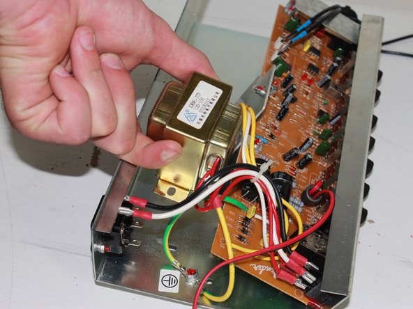

    3. Fender Frontman 15r Transformer Replacement: crwdns2935265:010crwdnd2935265:01crwdnd2935265:01crwdne2935265:0
      • Label, make note of, or memorize the arrangement of all wires going to and from from the transformer.
    4. Fender Frontman 15r Transformer Replacement: crwdns2935265:011crwdnd2935265:01crwdnd2935265:02crwdne2935265:0 Fender Frontman 15r Transformer Replacement: crwdns2935265:011crwdnd2935265:02crwdnd2935265:02crwdne2935265:0
      • Using wire cutters, cut the wires from the existing transformer leaving only enough wire next to the transformer to see the color of each cut wire. Then remove the transformer.
The new transformer will have wire leads that need to be spliced with the cut wires from the board and power switch. If you are unfamiliar with this process, here are the fundamentals of how to splice cut wires together.
