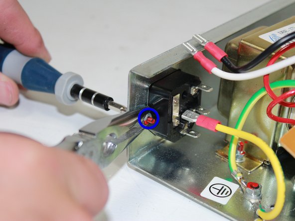

  9. Fender Frontman 15r Power Input Jack Replacement: crwdns2935265:09crwdnd2935265:01crwdnd2935265:02crwdne2935265:0 Fender Frontman 15r Power Input Jack Replacement: crwdns2935265:09crwdnd2935265:02crwdnd2935265:02crwdne2935265:0
    • Use Philips #1 Screwdriver to unscrew the two 12.1 mm screws on the exterior of the power input jack.
    • Hold the nut in place while unscrewing the 12.1 mm screws using a pair of needle nose pliers to prevent it from spinning.
  10. Fender Frontman 15r Power Input Jack Replacement: crwdns2935265:010crwdnd2935265:01crwdnd2935265:01crwdne2935265:0
    • Pull the power input jack out of the mounting bracket.
Once the old power jack is removed, to install the replacement power jack, follow the guide in reverse.
