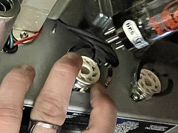

    • Remove the power stage vacuum tubes. Gently pull out the tube while simultaneously pressing down the metal holder.

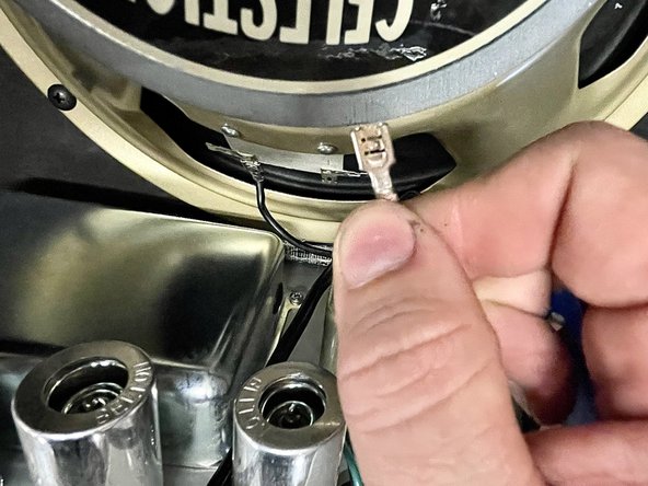

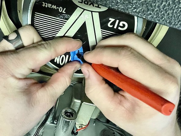

    • Remove the positive and negative speaker connections and label them accordingly with a marker and painter's tape.

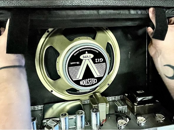

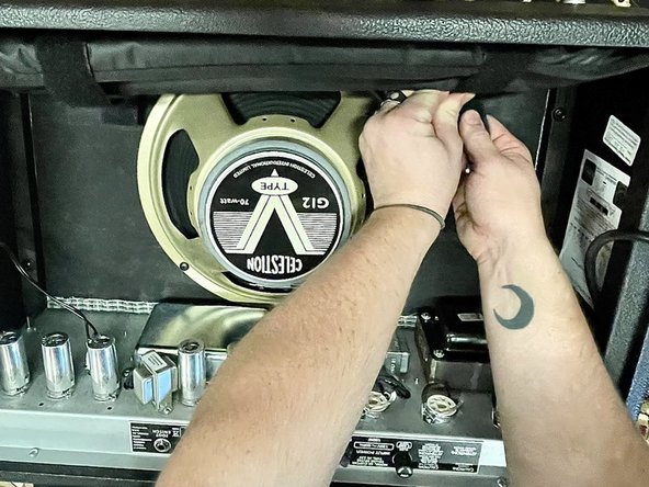

    • Remove the reverb tank by unscrewing two 1.2 mm screws with a Phillips #1 screwdriver and unfastening the velcro by hand.
    • The wire must stay connected.

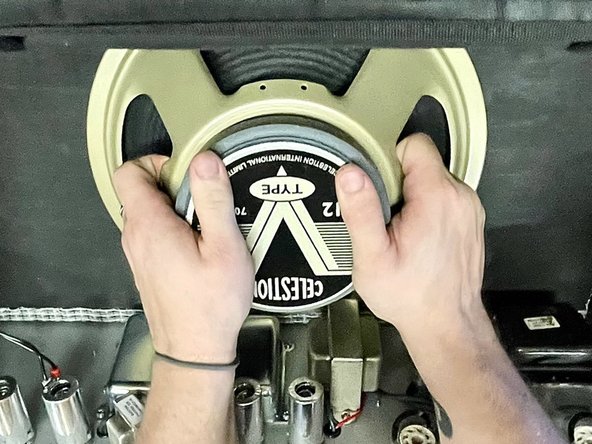

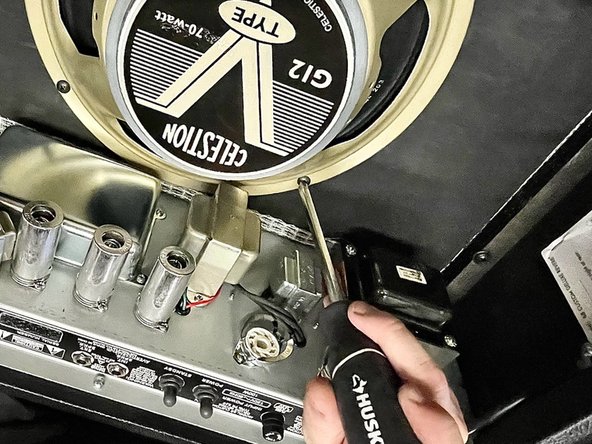

    • Remove the speaker by unscrewing four 1.2 mm screws with a Phillips #1 screwdriver.
    • Potential for device damage: Do not touch the front of the speaker when handling.
