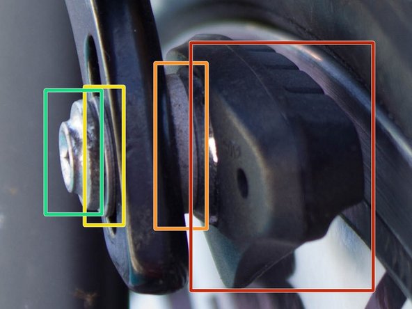

    • Locate Brake Caliper.
    • Use 4.0 mm allen key to remove main bolt.
    • Rotate counterclockwise to loosen.
    • Be careful not to lose both the washer and spacer found in-between the bolt and the brake pad mounting hole.
    • Repeat step 2 to remove the pad on the other side.
  3. Felt Z85 Brake Pad Replacement, Collecting parts (reinstall): crwdns2935265:03crwdnd2935265:01crwdnd2935265:02crwdne2935265:0 Felt Z85 Brake Pad Replacement, Collecting parts (reinstall): crwdns2935265:03crwdnd2935265:02crwdnd2935265:02crwdne2935265:0
    • Brake Pad: The item being replaced.
    • Spacer: This item will be reused.
    • Washer: This item will be reused.
    • 4 mm hex bolt.
    • Note order of mounting hardware for reinstall.
