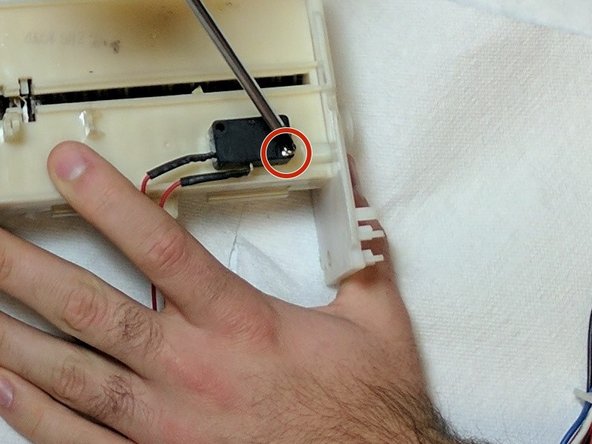

    1. Fellowes T7CM Trigger Sensor Replacement, Trigger Sensor: crwdns2935265:09crwdnd2935265:01crwdnd2935265:02crwdne2935265:0 Fellowes T7CM Trigger Sensor Replacement, Trigger Sensor: crwdns2935265:09crwdnd2935265:02crwdnd2935265:02crwdne2935265:0
      • Remove the screws holding the feeding sensor in place. The screw length is 10 mm and the head diameter is 6 mm.
      • Lift and remove the sensor.
      • Replace the faulty sensor with a new sensor.
