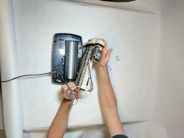

    4. Fellowes T7CM Shaft Replacement: crwdns2935265:04crwdnd2935265:01crwdnd2935265:01crwdne2935265:0
      • Open the casing as shown to prevent tangling or damaging the wires.
      • Take note to how the trigger assembly is attached before removal.
      • The trigger assembly is one part and should come off all together with little to no force applied.
      • Remove the trigger assembly.

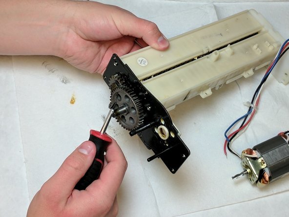

    4. Fellowes T7CM Shaft Replacement: crwdns2935265:08crwdnd2935265:01crwdnd2935265:03crwdne2935265:0 Fellowes T7CM Shaft Replacement: crwdns2935265:08crwdnd2935265:02crwdnd2935265:03crwdne2935265:0 Fellowes T7CM Shaft Replacement: crwdns2935265:08crwdnd2935265:03crwdnd2935265:03crwdne2935265:0
      • Remove the gears.
      • The larger gear located in the middle may require a screwdriver to pry off.
      • Remove the gear holder by unscrewing two screws that are holding it in place. The screw length is 14 mm and the head diameter is 5 mm.

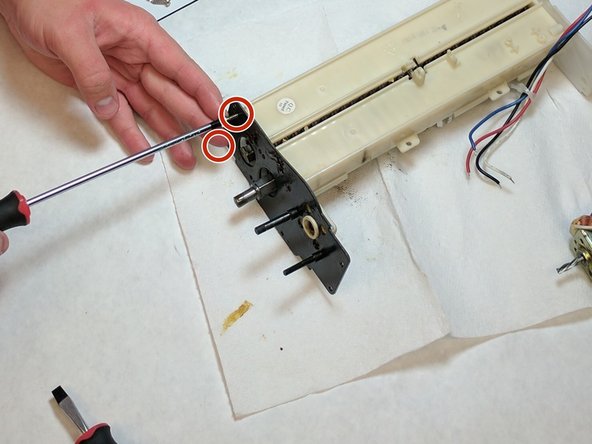

    5. Fellowes T7CM Shaft Replacement: crwdns2935265:09crwdnd2935265:01crwdnd2935265:02crwdne2935265:0 Fellowes T7CM Shaft Replacement: crwdns2935265:09crwdnd2935265:02crwdnd2935265:02crwdne2935265:0
      • Remove the pin in order to pull the casing off of the shafts.
      • Remove the casing in order to expose shafts.

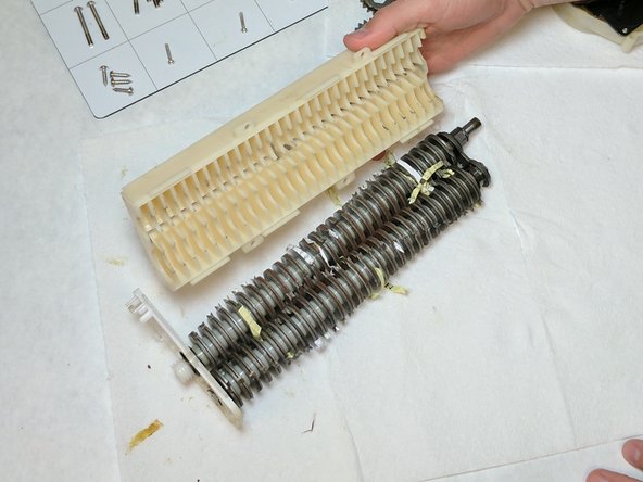

    1. Fellowes T7CM Shaft Replacement, Shaft: crwdns2935265:010crwdnd2935265:01crwdnd2935265:01crwdne2935265:0
      • Remove the metal attachment that holds the two shafts together.
    2. Fellowes T7CM Shaft Replacement: crwdns2935265:011crwdnd2935265:01crwdnd2935265:01crwdne2935265:0
      • The shafts can now be pulled apart and any obstructions located between or on each of the shafts can be removed.
