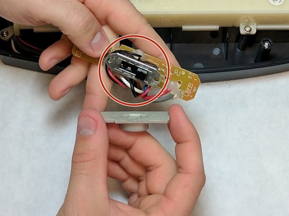

    1. Fellowes T7CM On,  Off, Reverse Switch Replacement, On,  Off, Reverse Switch: crwdns2935265:05crwdnd2935265:01crwdnd2935265:01crwdne2935265:0
      • Unscrew both of the screws from the circuit board of the switch . Lift the circuit board away from the device. The screw length is 10 mm and the head diameter is 6 mm.
    2. Fellowes T7CM On,  Off, Reverse Switch Replacement: crwdns2935265:06crwdnd2935265:01crwdnd2935265:02crwdne2935265:0 Fellowes T7CM On,  Off, Reverse Switch Replacement: crwdns2935265:06crwdnd2935265:02crwdnd2935265:02crwdne2935265:0
      • Remove the plastic switch case.
      • After the plastic case is removed, the switch can be replaced.
      • During the switch replacement, be careful of the springs that are held in side. They can potentially come loose and get lost.
