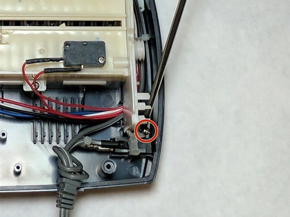

    1. Fellowes T7CM  Main Power Cord Replacement, Main Power Cord: crwdns2935265:05crwdnd2935265:01crwdnd2935265:02crwdne2935265:0 Fellowes T7CM  Main Power Cord Replacement, Main Power Cord: crwdns2935265:05crwdnd2935265:02crwdnd2935265:02crwdne2935265:0
      • Remove the wire holder. This is a small screwed in piece of plastic which holds the wires in place. The screw length is 10 mm and the head diameter is 6 mm.

      • Locate the main power cord.
      • Clip the wire and strip the remaining end of the wire. Twist the new cord together with the remaining old wire.
      • Use electrical tape in order to cover the wire splice.
