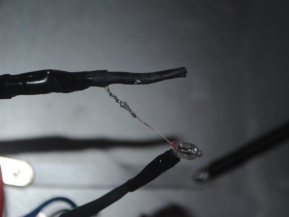

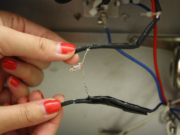

  5. Farberware FSTO100 Indicator Light Replacement: crwdns2935265:05crwdnd2935265:01crwdnd2935265:02crwdne2935265:0 Farberware FSTO100 Indicator Light Replacement: crwdns2935265:05crwdnd2935265:02crwdnd2935265:02crwdne2935265:0
    • Use scissors to cut open cord sheathing and peel back.
  6. Farberware FSTO100 Indicator Light Replacement: crwdns2935265:06crwdnd2935265:01crwdnd2935265:01crwdne2935265:0
    • Use the wire-cutters to remove the light bulb.
  7. Farberware FSTO100 Indicator Light Replacement: crwdns2935265:07crwdnd2935265:01crwdnd2935265:02crwdne2935265:0 Farberware FSTO100 Indicator Light Replacement: crwdns2935265:07crwdnd2935265:02crwdnd2935265:02crwdne2935265:0
    • Solder the replacement light bulb back onto its original position.
  8. Farberware FSTO100 Indicator Light Replacement: crwdns2935265:08crwdnd2935265:01crwdnd2935265:01crwdne2935265:0
    • Use electrical tape to reseal the sheathing.
