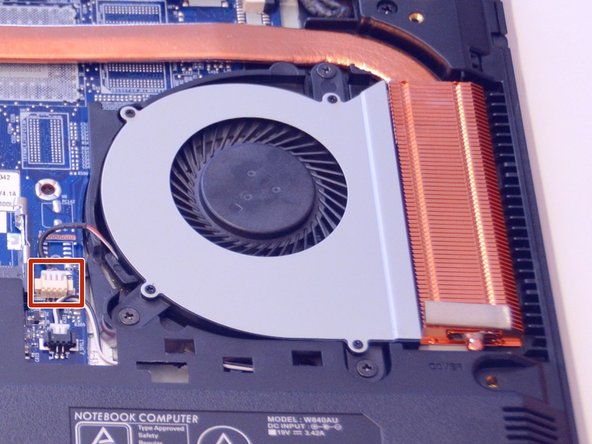

    1. Fan Replacement, Fan: crwdns2935265:04crwdnd2935265:01crwdnd2935265:03crwdne2935265:0 Fan Replacement, Fan: crwdns2935265:04crwdnd2935265:02crwdnd2935265:03crwdne2935265:0 Fan Replacement, Fan: crwdns2935265:04crwdnd2935265:03crwdnd2935265:03crwdne2935265:0
      • Here is the fan.
      • Disconnect the power cable from this one.
      • Unscrew the screws that hold it in place.
    2. Fan Replacement: crwdns2935265:05crwdnd2935265:01crwdnd2935265:01crwdne2935265:0
      • Gently lift the fan out of its slot.
To reassemble your device follow the following instructions in reverse order
