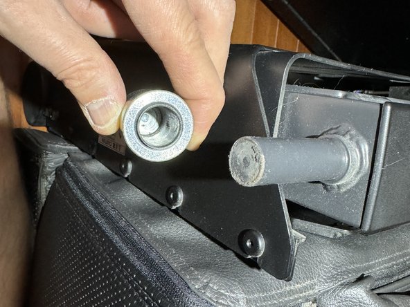

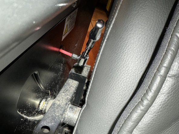

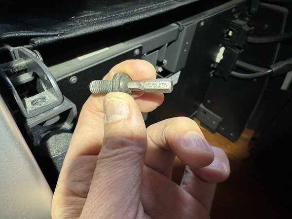

  2. Family Inada ROBO chair HCP-D5A Massage Chair Teardown, Mechanically separating the leg portion: crwdns2935265:03crwdnd2935265:01crwdnd2935265:02crwdne2935265:0 Family Inada ROBO chair HCP-D5A Massage Chair Teardown, Mechanically separating the leg portion: crwdns2935265:03crwdnd2935265:02crwdnd2935265:02crwdne2935265:0
    • Use 5 mm hex to remove the two bolts to the left or the two circles in the drawing
    • then lift up on the securing points latches
    • then you can lift up slightly on the leg portion to move it away from the chair
    • carefully as it is still attached electrically
    • the leg portion does had wheels on it so it moves easily after you lift it free (it is quite heavy)

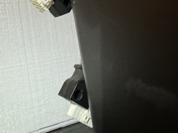

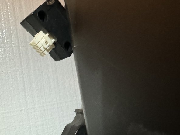

  4. Family Inada ROBO chair HCP-D5A Massage Chair Teardown, Electrically disconnecting the leg portion: crwdns2935265:05crwdnd2935265:01crwdnd2935265:03crwdne2935265:0 Family Inada ROBO chair HCP-D5A Massage Chair Teardown, Electrically disconnecting the leg portion: crwdns2935265:05crwdnd2935265:02crwdnd2935265:03crwdne2935265:0 Family Inada ROBO chair HCP-D5A Massage Chair Teardown, Electrically disconnecting the leg portion: crwdns2935265:05crwdnd2935265:03crwdnd2935265:03crwdne2935265:0
    • with a small flat head screw driver or similar, gently push the center of the connector toward the outside of the chair as you pull the entire connector forward.
    • There are two you need to disconnect to the right o the red squares.
    • 2nd photo shows them disconnected

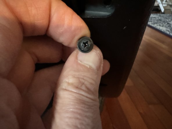

  5. Family Inada ROBO chair HCP-D5A Massage Chair Teardown, removing the lower side panels part 1: crwdns2935265:06crwdnd2935265:01crwdnd2935265:03crwdne2935265:0 Family Inada ROBO chair HCP-D5A Massage Chair Teardown, removing the lower side panels part 1: crwdns2935265:06crwdnd2935265:02crwdnd2935265:03crwdne2935265:0 Family Inada ROBO chair HCP-D5A Massage Chair Teardown, removing the lower side panels part 1: crwdns2935265:06crwdnd2935265:03crwdnd2935265:03crwdne2935265:0
    • there are three #2 Phillips screws to be removed along the back of the panel shown in yellow numbers on the first photo

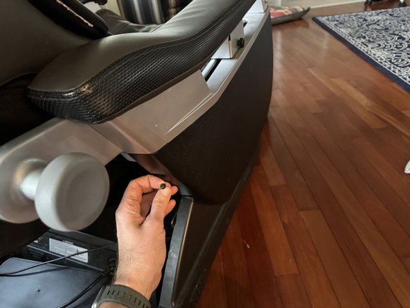

  6. Family Inada ROBO chair HCP-D5A Massage Chair Teardown, Removing the lower side panels part 2: crwdns2935265:07crwdnd2935265:01crwdnd2935265:02crwdne2935265:0 Family Inada ROBO chair HCP-D5A Massage Chair Teardown, Removing the lower side panels part 2: crwdns2935265:07crwdnd2935265:02crwdnd2935265:02crwdne2935265:0
    • there are four #2 Phillips screws to be removed along the front and top of the panel shown in red numbers on the first photo
    • The second photos shows how the top center screw can be Gard to get to
    • all of these screws are accessed from the inside of the arm rest. Near where the outsides of where your thighs would be if you were sitting in the chair

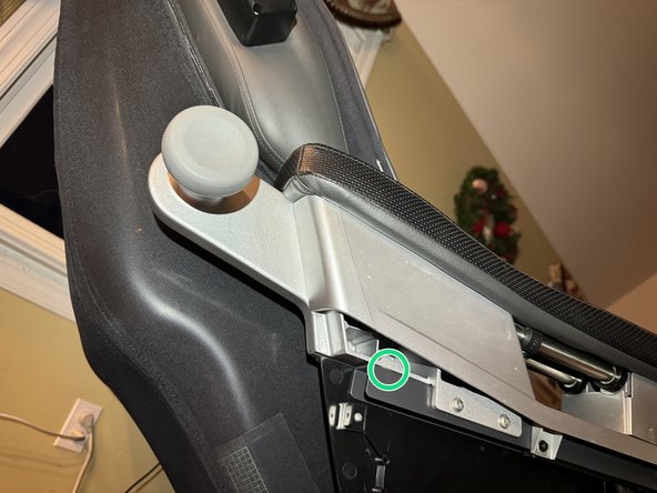

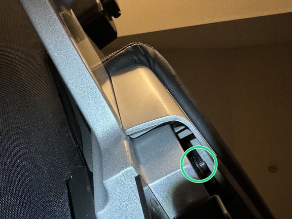

  7. Family Inada ROBO chair HCP-D5A Massage Chair Teardown, Behind the side panel: crwdns2935265:08crwdnd2935265:01crwdnd2935265:02crwdne2935265:0 Family Inada ROBO chair HCP-D5A Massage Chair Teardown, Behind the side panel: crwdns2935265:08crwdnd2935265:02crwdnd2935265:02crwdne2935265:0
    • here I checked all the screws tight. the larger ones are #3 Phillips while the smaller ones are #2
    • The 2nd photo shows the screw I found loose that was making my arm rest move too much

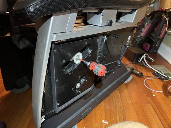

  8. Family Inada ROBO chair HCP-D5A Massage Chair Teardown, Probable side panel main attachment points: crwdns2935265:09crwdnd2935265:01crwdnd2935265:03crwdne2935265:0 Family Inada ROBO chair HCP-D5A Massage Chair Teardown, Probable side panel main attachment points: crwdns2935265:09crwdnd2935265:02crwdnd2935265:03crwdne2935265:0 Family Inada ROBO chair HCP-D5A Massage Chair Teardown, Probable side panel main attachment points: crwdns2935265:09crwdnd2935265:03crwdnd2935265:03crwdne2935265:0
    • I think the entire side panel is attached by the three circles shown in the photo
    • to the right of the two red circles and to the upper left of the green circle are the three points
    • probably have to disassemble the grey plastic below the arm rest to get to the green bolt
