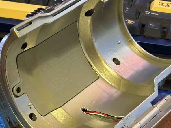

  1. Fallout Series Pip-Boy Die-Cast Replica Micro SD Card Replacement, Getting to the Battery Panel: crwdns2935265:01crwdnd2935265:01crwdnd2935265:02crwdne2935265:0 Fallout Series Pip-Boy Die-Cast Replica Micro SD Card Replacement, Getting to the Battery Panel: crwdns2935265:01crwdnd2935265:02crwdnd2935265:02crwdne2935265:0
    • Gently Remove the arm foam and black backing on the side with the screen. No glue to worry about. This should give you access to the Screw Holes needed to open up the device.
  2. Fallout Series Pip-Boy Die-Cast Replica Micro SD Card Replacement, Prepping for Battery Removal: crwdns2935265:02crwdnd2935265:01crwdnd2935265:02crwdne2935265:0 Fallout Series Pip-Boy Die-Cast Replica Micro SD Card Replacement, Prepping for Battery Removal: crwdns2935265:02crwdnd2935265:02crwdnd2935265:02crwdne2935265:0
    • Unscrew the back with a Phillips Screwdriver. It will open to reveal the 2500Mah battery

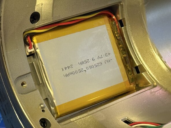

  3. Fallout Series Pip-Boy Die-Cast Replica Micro SD Card Replacement, Removing The Battery: crwdns2935265:03crwdnd2935265:01crwdnd2935265:02crwdne2935265:0 Fallout Series Pip-Boy Die-Cast Replica Micro SD Card Replacement, Removing The Battery: crwdns2935265:03crwdnd2935265:02crwdnd2935265:02crwdne2935265:0
    • Move the battery out of the way. There's no glue or anything holding it.

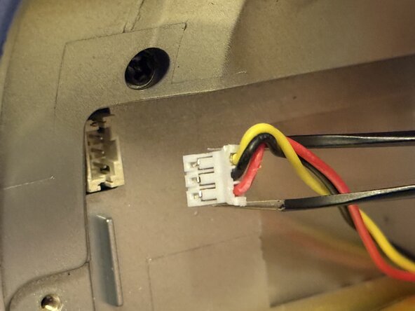

    • With Tweezers, Pull out the cable.
  4. Fallout Series Pip-Boy Die-Cast Replica Micro SD Card Replacement, Unscrew More Screws: crwdns2935265:04crwdnd2935265:01crwdnd2935265:01crwdne2935265:0
    • Now Unscrew the four screws surrounding the battery slot. The Same Phillips screwdriver size should work.

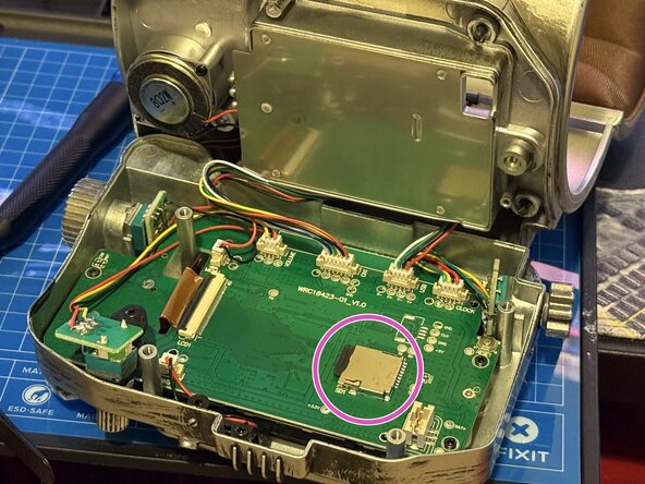

  5. Fallout Series Pip-Boy Die-Cast Replica Micro SD Card Replacement, Open the Front: crwdns2935265:05crwdnd2935265:01crwdnd2935265:02crwdne2935265:0 Fallout Series Pip-Boy Die-Cast Replica Micro SD Card Replacement, Open the Front: crwdns2935265:05crwdnd2935265:02crwdnd2935265:02crwdne2935265:0
    • With the screws gone, GENTLY move the front off the Pip-boy so you don't destroy any cables. It should just slide off as the screws kept it on.
    • You should immediately see the Micro SD Card, circled in pink.
  6. Fallout Series Pip-Boy Die-Cast Replica Micro SD Card Replacement, Replace the SD Card: crwdns2935265:06crwdnd2935265:01crwdnd2935265:01crwdne2935265:0
    • Press down on the SD card to pop it out. Swap it out with another.
