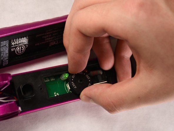

    • Using Philips head #1 remove the two 4 mm silver screws on the sides of dial panel cover.
  6. Fahrenheit FHT 125PRMR Motherboard Replacement: crwdns2935265:06crwdnd2935265:01crwdnd2935265:02crwdne2935265:0 Fahrenheit FHT 125PRMR Motherboard Replacement: crwdns2935265:06crwdnd2935265:02crwdnd2935265:02crwdne2935265:0
    • Using Philips head #00 to remove the 4 mm silver screw on the dial. Remove the dial with your hand.
  7. Fahrenheit FHT 125PRMR Motherboard Replacement: crwdns2935265:07crwdnd2935265:01crwdnd2935265:01crwdne2935265:0
    • Remove the covering panel by pulling up with your hand.
  8. Fahrenheit FHT 125PRMR Motherboard Replacement: crwdns2935265:08crwdnd2935265:01crwdnd2935265:02crwdne2935265:0 Fahrenheit FHT 125PRMR Motherboard Replacement: crwdns2935265:08crwdnd2935265:02crwdnd2935265:02crwdne2935265:0
    • Remove three 3 mm sliver screws #1 from the motherboard.
    • Use your hand to life the motherboard out of the flat iron.
