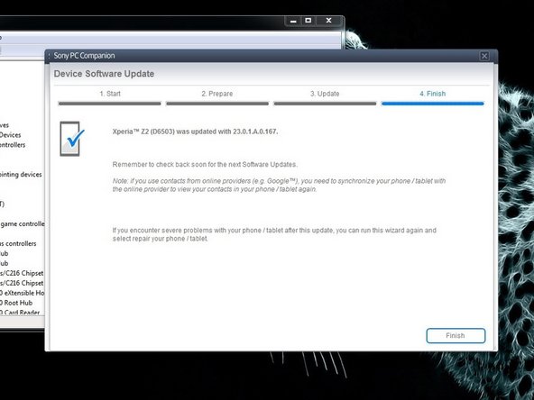

      • Once connected, PC Companion will download necessary firmware and will upload it to your phone.
    7. Factory Reset, Fix Android Problems  with Sony PC Companion: crwdns2935265:07crwdnd2935265:01crwdnd2935265:03crwdne2935265:0 Factory Reset, Fix Android Problems  with Sony PC Companion: crwdns2935265:07crwdnd2935265:02crwdnd2935265:03crwdne2935265:0 Factory Reset, Fix Android Problems  with Sony PC Companion: crwdns2935265:07crwdnd2935265:03crwdnd2935265:03crwdne2935265:0
      • Your PC must recognize your phone like SOMC Flash Device.
      • If you have a problem with drivers (your PC can't recognize your phone), search in the internet for "S1Boot Fastboot" drivers or use the link below.
      • '''Android WinUSB drivers'''
    8. Factory Reset, Fix Android Problems  with Sony PC Companion: crwdns2935265:08crwdnd2935265:01crwdnd2935265:03crwdne2935265:0 Factory Reset, Fix Android Problems  with Sony PC Companion: crwdns2935265:08crwdnd2935265:02crwdnd2935265:03crwdne2935265:0 Factory Reset, Fix Android Problems  with Sony PC Companion: crwdns2935265:08crwdnd2935265:03crwdnd2935265:03crwdne2935265:0

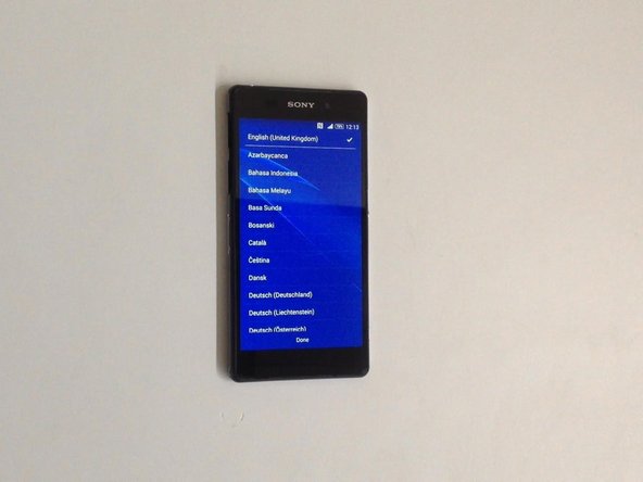

      • When PC Companion finished with update process, disconnect the phone and switch it on.
      • Now your phone is in factory condition, with erased custom data and without password protection.
