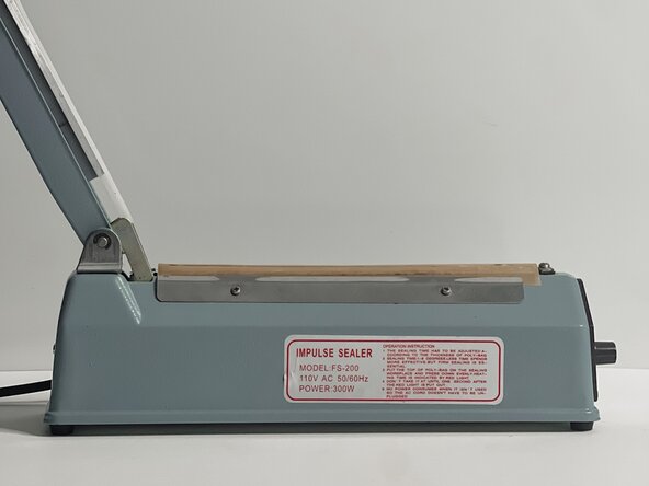

FS-200 Impulse Heat Sealer Heating Element Replacement
  1. FS-200 Impulse Heat Sealer Heating Element Replacement, Heating Element: crwdns2935265:01crwdnd2935265:01crwdnd2935265:02crwdne2935265:0 FS-200 Impulse Heat Sealer Heating Element Replacement, Heating Element: crwdns2935265:01crwdnd2935265:02crwdnd2935265:02crwdne2935265:0

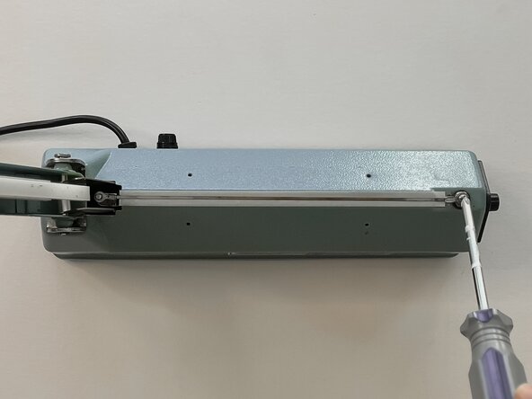

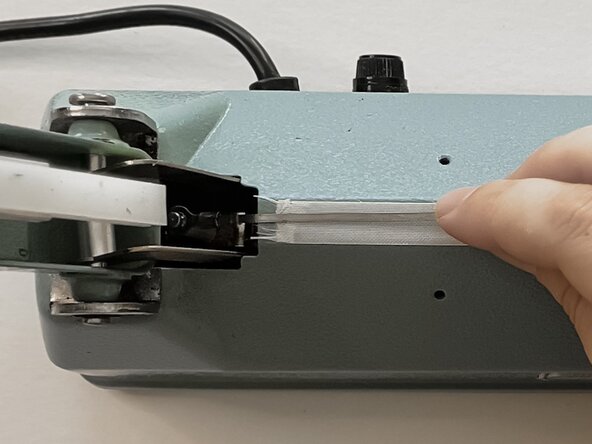

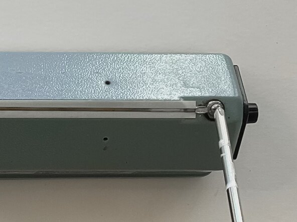

    • Unplug the heat sealer from any power source and make sure the heat sealer isn't hot.
    • Lift the sealing arm and position it up and out of the way to create space for the replacement.

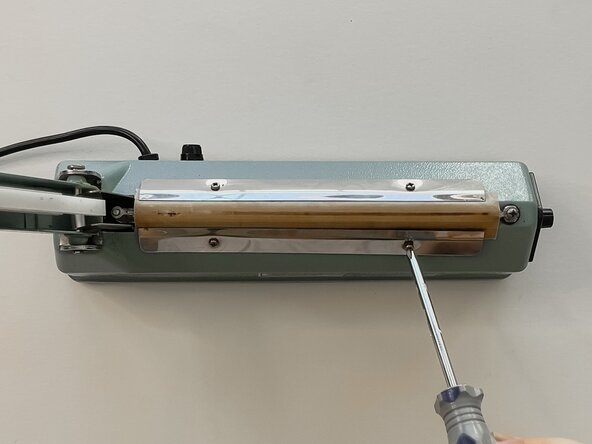

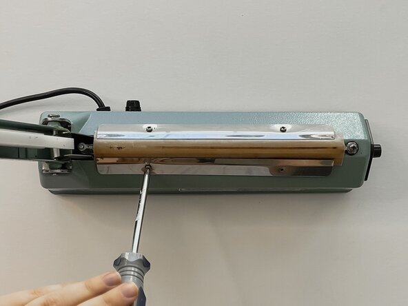

  2. FS-200 Impulse Heat Sealer Heating Element Replacement: crwdns2935265:02crwdnd2935265:01crwdnd2935265:03crwdne2935265:0 FS-200 Impulse Heat Sealer Heating Element Replacement: crwdns2935265:02crwdnd2935265:02crwdnd2935265:03crwdne2935265:0 FS-200 Impulse Heat Sealer Heating Element Replacement: crwdns2935265:02crwdnd2935265:03crwdnd2935265:03crwdne2935265:0
    • Using a standard Phillips #2 screwdriver, remove the first two screws to detach the first metal panel.
  3. FS-200 Impulse Heat Sealer Heating Element Replacement: crwdns2935265:03crwdnd2935265:01crwdnd2935265:02crwdne2935265:0 FS-200 Impulse Heat Sealer Heating Element Replacement: crwdns2935265:03crwdnd2935265:02crwdnd2935265:02crwdne2935265:0
    • Using a standard Phillips #2 screwdriver, unscrew the remaining two screws to remove the second metal panel.

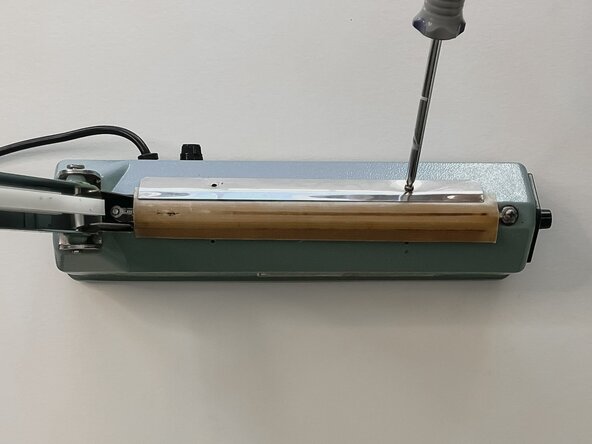

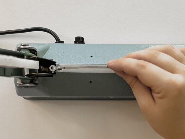

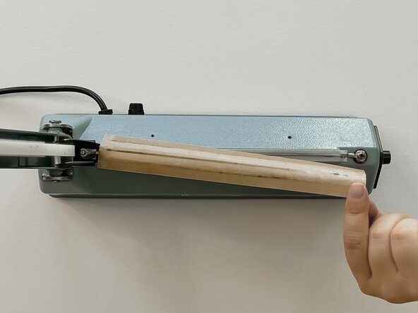

  4. FS-200 Impulse Heat Sealer Heating Element Replacement: crwdns2935265:04crwdnd2935265:01crwdnd2935265:02crwdne2935265:0 FS-200 Impulse Heat Sealer Heating Element Replacement: crwdns2935265:04crwdnd2935265:02crwdnd2935265:02crwdne2935265:0
    • Remove the teflon strip to expose the heating element wire.
  5. FS-200 Impulse Heat Sealer Heating Element Replacement: crwdns2935265:05crwdnd2935265:01crwdnd2935265:03crwdne2935265:0 FS-200 Impulse Heat Sealer Heating Element Replacement: crwdns2935265:05crwdnd2935265:02crwdnd2935265:03crwdne2935265:0 FS-200 Impulse Heat Sealer Heating Element Replacement: crwdns2935265:05crwdnd2935265:03crwdnd2935265:03crwdne2935265:0
    • Using a standard Phillips #2 screwdriver, unscrew the large single screw and remove the old heating element wire.
