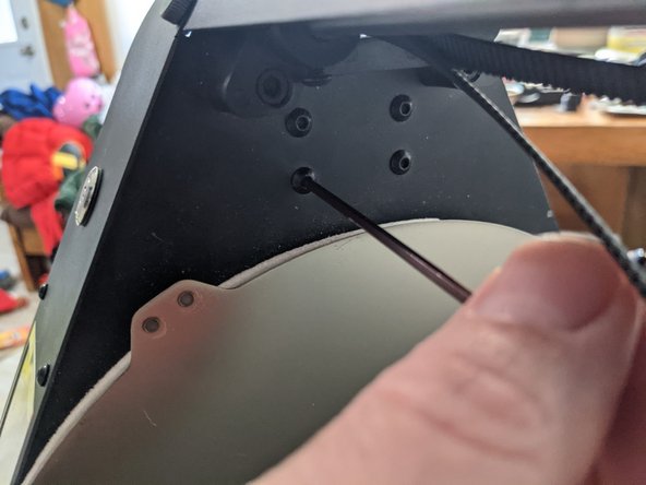

  5. FLSUN QQ Stepper Motor Damper Replacement, Remove Belt from Stepper Motor: crwdns2935265:05crwdnd2935265:01crwdnd2935265:02crwdne2935265:0 FLSUN QQ Stepper Motor Damper Replacement, Remove Belt from Stepper Motor: crwdns2935265:05crwdnd2935265:02crwdnd2935265:02crwdne2935265:0
    • use 2mm hex key to remove belt cover
    • remove belt from stepper motor
    • use 2.5mm hex key to remove stepper motor bracket from the top side

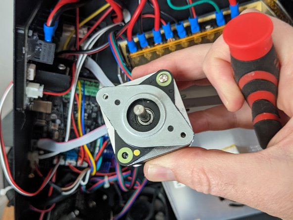

  7. FLSUN QQ Stepper Motor Damper Replacement, Remove Motor Bracket: crwdns2935265:07crwdnd2935265:01crwdnd2935265:01crwdne2935265:0
    • use hex key to remove last screw from the stepper motor mount

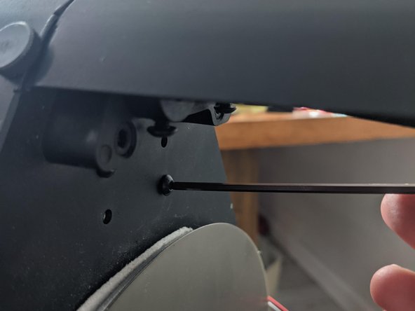

  8. FLSUN QQ Stepper Motor Damper Replacement, Replace Damaged Damper: crwdns2935265:08crwdnd2935265:01crwdnd2935265:03crwdne2935265:0 FLSUN QQ Stepper Motor Damper Replacement, Replace Damaged Damper: crwdns2935265:08crwdnd2935265:02crwdnd2935265:03crwdne2935265:0 FLSUN QQ Stepper Motor Damper Replacement, Replace Damaged Damper: crwdns2935265:08crwdnd2935265:03crwdnd2935265:03crwdne2935265:0
    • use hex key to remove 2 screws holding the damper to the stepper motor
    • use Phillips #1 to install new damper
    • alternatively, use hex key to install new damper with old screws
