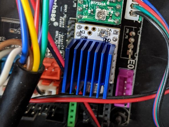

  3. FLSUN QQ Stepper Driver Replacement (TMC2208), Plug In the New TMC2208 Driver: crwdns2935265:05crwdnd2935265:01crwdnd2935265:01crwdne2935265:0
    • Align the pins in the correct location and position.
    • In my case the blue header on the TMC2208 aligned with the green side of the socket on the board.
    • Press gently but firmly into place.

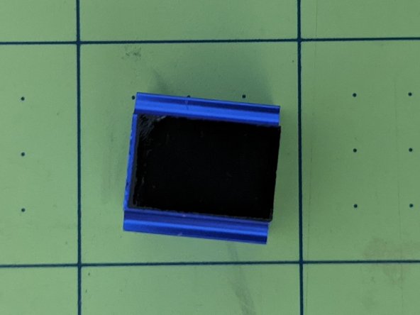

  4. FLSUN QQ Stepper Driver Replacement (TMC2208), Install Heat Sink: crwdns2935265:06crwdnd2935265:01crwdnd2935265:03crwdne2935265:0 FLSUN QQ Stepper Driver Replacement (TMC2208), Install Heat Sink: crwdns2935265:06crwdnd2935265:02crwdnd2935265:03crwdne2935265:0 FLSUN QQ Stepper Driver Replacement (TMC2208), Install Heat Sink: crwdns2935265:06crwdnd2935265:03crwdnd2935265:03crwdne2935265:0
    • Avoid shorting out any of the pins. Do not place heat sink in contact with any of the pins.
    • Remove sticker from back of heat sink
    • Carefully press the heat sink to the back of the TMC2208
    • Remove Old Driver
    • Reverse Direction of Stepper
    • Insert TMC2208
    • Add Heatsink
    • Plug Stepper Back In
