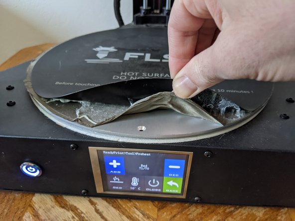

    • Heating the bed will melt the adhesive and make removing the old print surface much easier
  3. FLSUN QQ Print Surface Replacement, Peel up Old Print Bed: crwdns2935265:03crwdnd2935265:01crwdnd2935265:03crwdne2935265:0 FLSUN QQ Print Surface Replacement, Peel up Old Print Bed: crwdns2935265:03crwdnd2935265:02crwdnd2935265:03crwdne2935265:0 FLSUN QQ Print Surface Replacement, Peel up Old Print Bed: crwdns2935265:03crwdnd2935265:03crwdnd2935265:03crwdne2935265:0

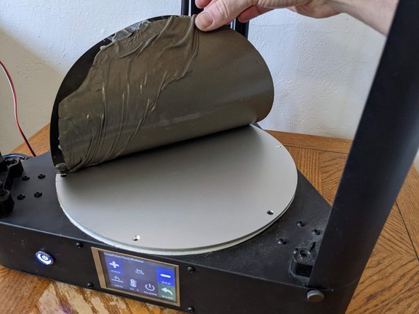

    • Use the putty knife to start peeling up the old bed.
    • Once you get the edge started you should be able to peel the rest by hand.

    • Use mineral spirits, gloves, and cotton balls to clean the bed
    • Leave the steel plate and magnetic sticker together.
    • Remove the backing from the magnetic sticker.
    • Be sure to align the plate exactly how you want it. Once the sticker is applied it is very difficult to remove and repositioning is not recommended.
    • Carefully apply the sticker and plate from one edge to the other.

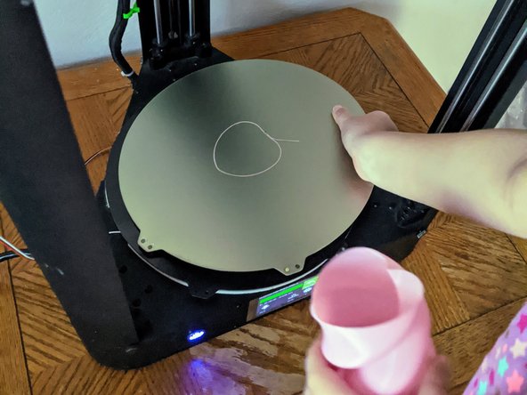

  6. FLSUN QQ Print Surface Replacement, Print Something: crwdns2935265:08crwdnd2935265:01crwdnd2935265:01crwdne2935265:0
    • Watch the first layer go down smoother than ever.
  7. FLSUN QQ Print Surface Replacement, Remove the Print with Ease: crwdns2935265:09crwdnd2935265:01crwdnd2935265:02crwdne2935265:0 FLSUN QQ Print Surface Replacement, Remove the Print with Ease: crwdns2935265:09crwdnd2935265:02crwdnd2935265:02crwdne2935265:0
    • Peel spring steel plate off of magnetic sticker.
    • Flex plate gently to detach print.
    • Retrieve print (I dropped the first one)
