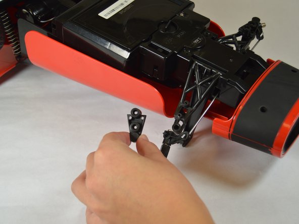

    • Position device so that the wheels are on a firm surface .
    • Using a J1 Screwdriver bit, remove the 11 mm screw from the center of the wheel.
  2. FAO Schwarz Apex 1 Front Wheel Springs Replacement: crwdns2935265:02crwdnd2935265:01crwdnd2935265:01crwdne2935265:0
    • After removing the 11 mm screw, firmly grip the wheel and pull away from the vehicle.
  3. FAO Schwarz Apex 1 Front Wheel Springs Replacement, Front Wheel Springs: crwdns2935265:03crwdnd2935265:01crwdnd2935265:02crwdne2935265:0 FAO Schwarz Apex 1 Front Wheel Springs Replacement, Front Wheel Springs: crwdns2935265:03crwdnd2935265:02crwdnd2935265:02crwdne2935265:0
    • Position device upside down so that the screws on the plastic axle pieces can be removed.
    • Use J1 screwdriver bit to remove two 10 mm screws to remove the plastic axle pieces to make access to the telescopic piston easier.
  4. FAO Schwarz Apex 1 Front Wheel Springs Replacement: crwdns2935265:04crwdnd2935265:01crwdnd2935265:01crwdne2935265:0
    • Secure a firm grip on the spring and telescopic piston.
    • Pull telescopic piston holding the spring off the device (this may be difficult).
  5. FAO Schwarz Apex 1 Front Wheel Springs Replacement: crwdns2935265:05crwdnd2935265:01crwdnd2935265:01crwdne2935265:0
    • Using a tool such as a spudger, gradually maneuver spring off of telescopic piston.
