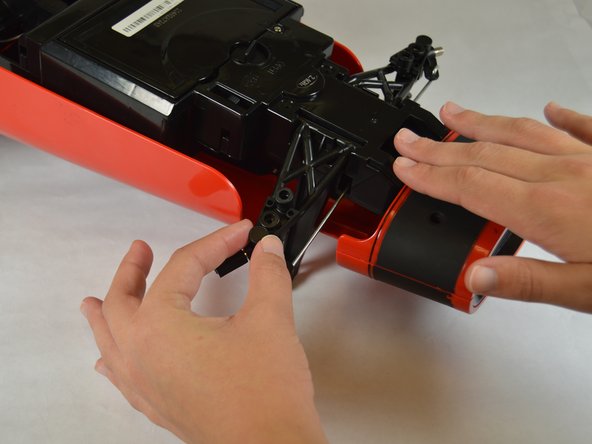

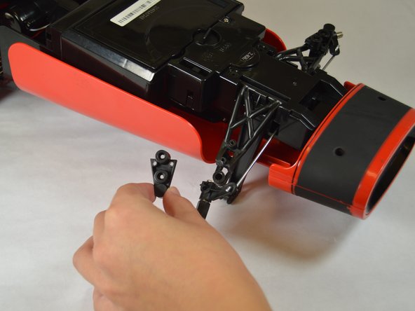

  6. FAO Schwarz Apex 1 Front Axle Replacement, Front Axle: crwdns2935265:06crwdnd2935265:01crwdnd2935265:03crwdne2935265:0 FAO Schwarz Apex 1 Front Axle Replacement, Front Axle: crwdns2935265:06crwdnd2935265:02crwdnd2935265:03crwdne2935265:0 FAO Schwarz Apex 1 Front Axle Replacement, Front Axle: crwdns2935265:06crwdnd2935265:03crwdnd2935265:03crwdne2935265:0
    • Carefully turn the vehicle over so that the bottom side is facing upward.
    • Using a J1 Screwdriver bit, remove the two 10 mm screws that secure the wheel bearing.
    • Pull the plastic piece that secures the wheel bearing off of the axle.

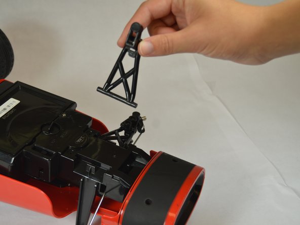

  7. FAO Schwarz Apex 1 Front Axle Replacement: crwdns2935265:07crwdnd2935265:01crwdnd2935265:02crwdne2935265:0 FAO Schwarz Apex 1 Front Axle Replacement: crwdns2935265:07crwdnd2935265:02crwdnd2935265:02crwdne2935265:0
    • Position the axle entirely upright before lifting away from the vehicle.
