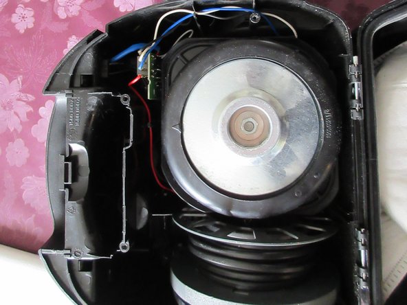

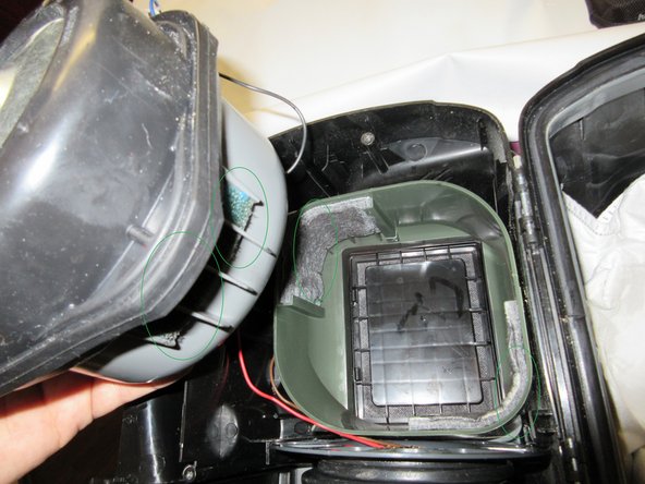

  4. FAKIR 1800 ECO: crwdns2935265:04crwdnd2935265:01crwdnd2935265:03crwdne2935265:0 FAKIR 1800 ECO: crwdns2935265:04crwdnd2935265:02crwdnd2935265:03crwdne2935265:0 FAKIR 1800 ECO: crwdns2935265:04crwdnd2935265:03crwdnd2935265:03crwdne2935265:0
    • PULL the turbine,it has a stuck rubber case. Just PULL.

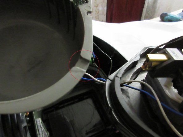

    • Then again, just pull, the grey Plasticpart. Look at the filters, they have to face eachother when you reassembel it !!! Marked in GREEN circles
    • Look at red circle, there is a notch, there is where the White cable, the blue cable and the black cable go through the housing.

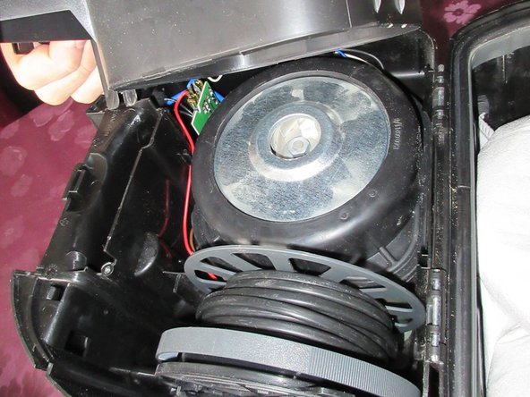

  5. FAKIR 1800 ECO: crwdns2935265:05crwdnd2935265:01crwdnd2935265:03crwdne2935265:0 FAKIR 1800 ECO: crwdns2935265:05crwdnd2935265:02crwdnd2935265:03crwdne2935265:0 FAKIR 1800 ECO: crwdns2935265:05crwdnd2935265:03crwdnd2935265:03crwdne2935265:0
    • Detail of white cable and blue cable. The plugs have a small springholder, you must push and then pull off !!
    • The plugs have different sizes.
    • Unplug the short black cable at the motor. The plug has again a spring which should be pushed, then pull off teh black cable.

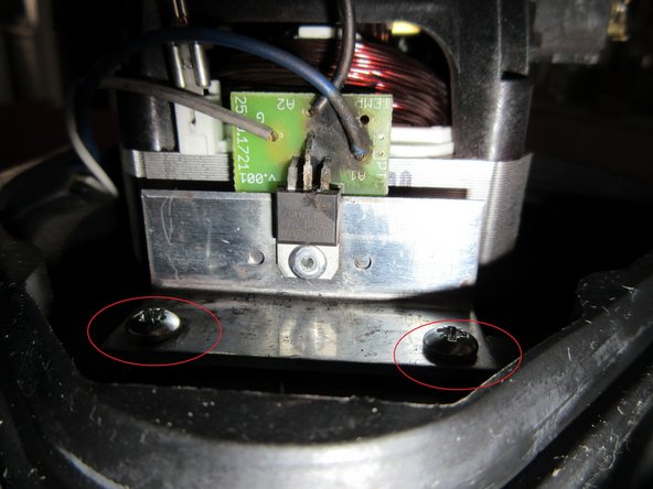

  6. FAKIR 1800 ECO: crwdns2935265:06crwdnd2935265:01crwdnd2935265:03crwdne2935265:0 FAKIR 1800 ECO: crwdns2935265:06crwdnd2935265:02crwdnd2935265:03crwdne2935265:0 FAKIR 1800 ECO: crwdns2935265:06crwdnd2935265:03crwdnd2935265:03crwdne2935265:0

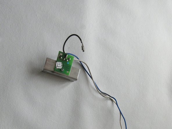

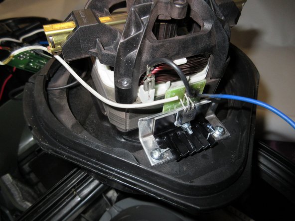

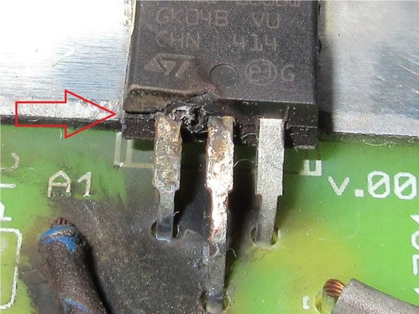

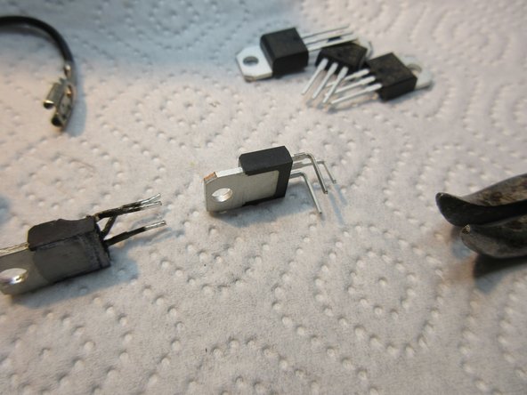

    • there you have it. The destroyed burnt TRIAC with cables and aluminium-cooling.
    • This one broke at the housing, look at the red arrow. The pins are bent directly at the housing, so this destruction occured at the montage of the triac ! bad. :( The current let it explode and damaged it complete.
    • cables look ok, platine is ok too. It looks burnt, but this is only black smoke.
    • Now we have to drill out that part...

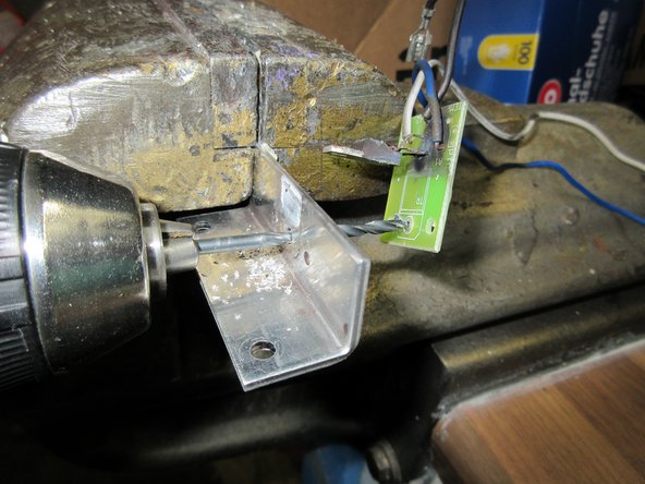

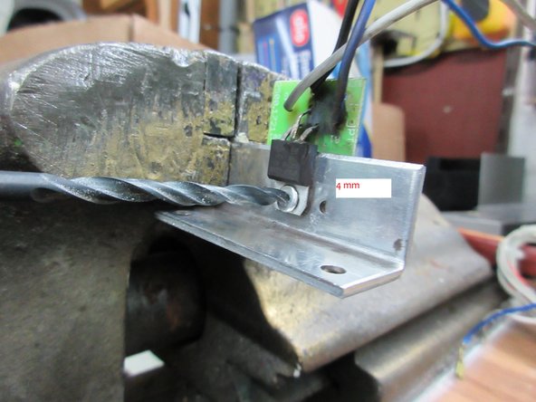

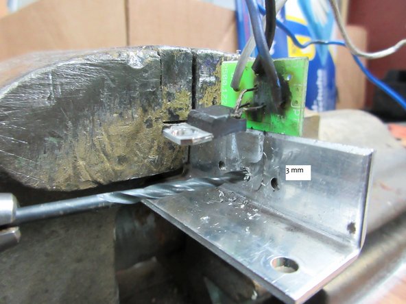

  7. FAKIR 1800 ECO: crwdns2935265:07crwdnd2935265:01crwdnd2935265:03crwdne2935265:0 FAKIR 1800 ECO: crwdns2935265:07crwdnd2935265:02crwdnd2935265:03crwdne2935265:0 FAKIR 1800 ECO: crwdns2935265:07crwdnd2935265:03crwdnd2935265:03crwdne2935265:0
    • first take a 4 mm Drill.
    • Carefully make that part.
  8. FAKIR 1800 ECO: crwdns2935265:08crwdnd2935265:01crwdnd2935265:03crwdne2935265:0 FAKIR 1800 ECO: crwdns2935265:08crwdnd2935265:02crwdnd2935265:03crwdne2935265:0 FAKIR 1800 ECO: crwdns2935265:08crwdnd2935265:03crwdnd2935265:03crwdne2935265:0
    • then pull the dead TRIAC up.
    • then you drill with 3 mm to get through the platine.
    • there you have it, all parts separated. :)

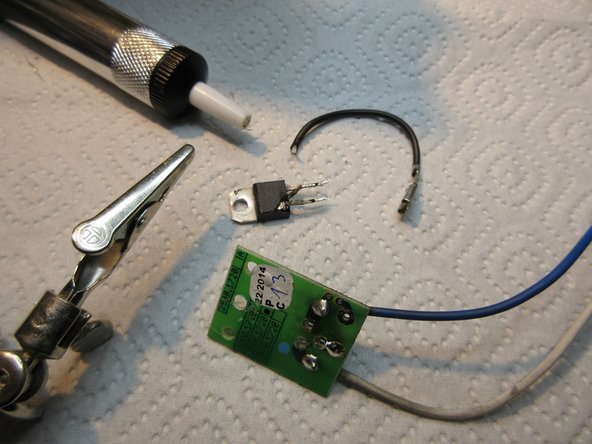

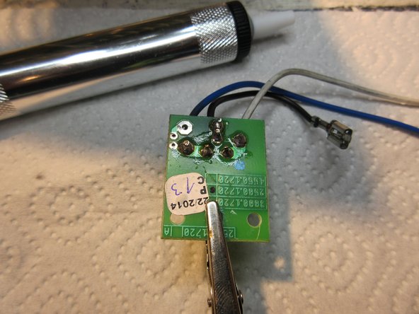

  9. FAKIR 1800 ECO: crwdns2935265:09crwdnd2935265:01crwdnd2935265:03crwdne2935265:0 FAKIR 1800 ECO: crwdns2935265:09crwdnd2935265:02crwdnd2935265:03crwdne2935265:0 FAKIR 1800 ECO: crwdns2935265:09crwdnd2935265:03crwdnd2935265:03crwdne2935265:0
    Desoldering Pump
    $3.99

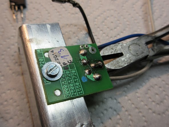

    • now desolder it. The platine has two holes which fit on the aluminium-cooler.
    • No problem with desoldering pump.
  10. FAKIR 1800 ECO: crwdns2935265:010crwdnd2935265:01crwdnd2935265:03crwdne2935265:0 FAKIR 1800 ECO: crwdns2935265:010crwdnd2935265:02crwdnd2935265:03crwdne2935265:0 FAKIR 1800 ECO: crwdns2935265:010crwdnd2935265:03crwdnd2935265:03crwdne2935265:0

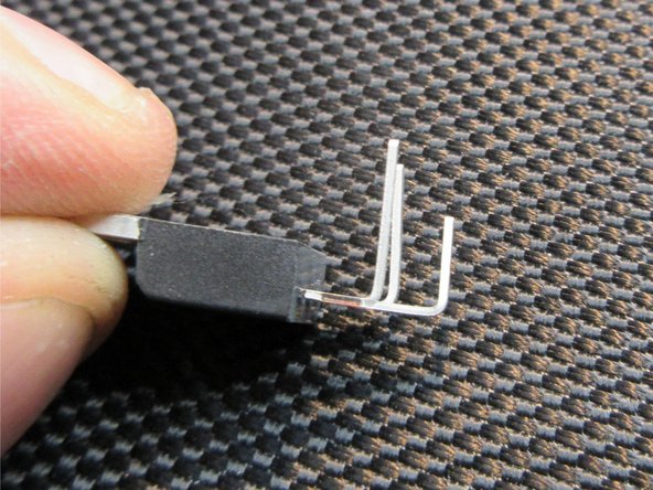

    • the new one.
    • follow the steps like on the pictures, i can't explain it, sorry. Like on the pictures, you can see, do it too.
  11. FAKIR 1800 ECO: crwdns2935265:011crwdnd2935265:01crwdnd2935265:02crwdne2935265:0 FAKIR 1800 ECO: crwdns2935265:011crwdnd2935265:02crwdnd2935265:02crwdne2935265:0
    • take some thermal componund. Only a very little amount.
    • take M3 screw, M3 washer and mount it to the aluminium-part.
    • solder the new part after the mechanical stress.

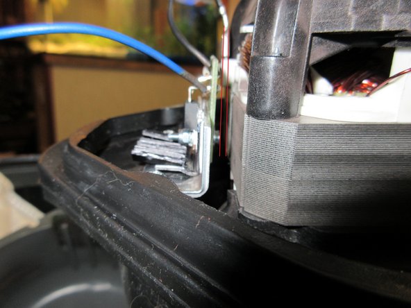

  13. FAKIR 1800 ECO: crwdns2935265:013crwdnd2935265:01crwdnd2935265:03crwdne2935265:0 FAKIR 1800 ECO: crwdns2935265:013crwdnd2935265:02crwdnd2935265:03crwdne2935265:0 FAKIR 1800 ECO: crwdns2935265:013crwdnd2935265:03crwdnd2935265:03crwdne2935265:0
    • NOW REASSEMBLING
    • put it back, then you need the two SHORT ph2 screws.
    • Take care of the distance between the parts as shown on the third picture, i marked it with two red lines.

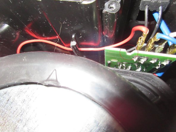

    • then put the white and the blue cable in place, there is also a second long black cable.
    • Look at the notch, it must fit right.
    • take care of the right fit of the filters there.

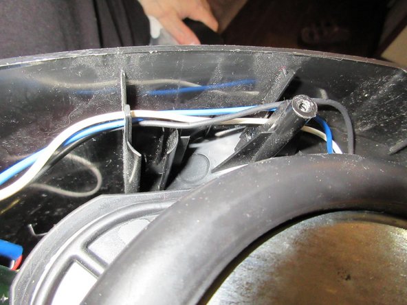

  16. FAKIR 1800 ECO: crwdns2935265:016crwdnd2935265:01crwdnd2935265:03crwdne2935265:0 FAKIR 1800 ECO: crwdns2935265:016crwdnd2935265:02crwdnd2935265:03crwdne2935265:0 FAKIR 1800 ECO: crwdns2935265:016crwdnd2935265:03crwdnd2935265:03crwdne2935265:0
    • Detail of the cables.
    • There are notches to hold the cables.
    • Lokk, there is a big notch in the platine of the third picture. RED CIRCLE. In this notch grips a latch of the housing when you close that part. Look at Steps 1 to 4 to see where you must take care of latches and notches and clipse.

Step 6, 2nd bullet [I know, out of order, but I wanted to use PCB, so translated it first] - Instead of translating it "The pins are bent directly at the housing, so this destruction occured at the montage of the triac !" I would've said "The pins are bent to go into the PCB, and the destructive forces inside the triac caused the assembly ("montage") to burst open at the other end of the pins, where they enter the triac housing!"
Steps 7-8 - there is a rivet that goes through the triack, then through the heat sink, then through the PCB. For getting the rivet out, you drill with a 4mm drill bit through the rivet head, through the triac mount, and lift the triac out of the way, then continue very carefully through the heat sink. Now the PCB can be removed from the heat sink. Then switch to a 3mm bit and drill the remnants of the rivet out of the PCB.

Step 10 - "follow the steps like on the pictures, i can't explain it, sorry. Like on the pictures, you can see, do it too" becomes "Follow the pictures in steps 4-10, especially step 6 and step 10. Pins 1 and 3 get bent closer to the triac, pin 2 (the middle pin) gets bent further out ('longer') from the triac, to fit the wholes in the PCB.
