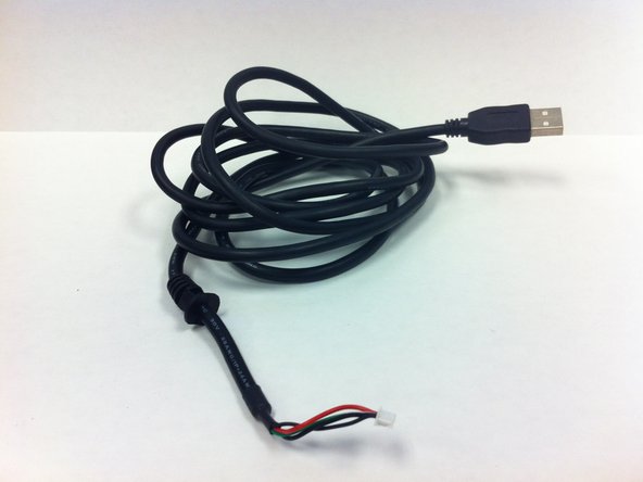

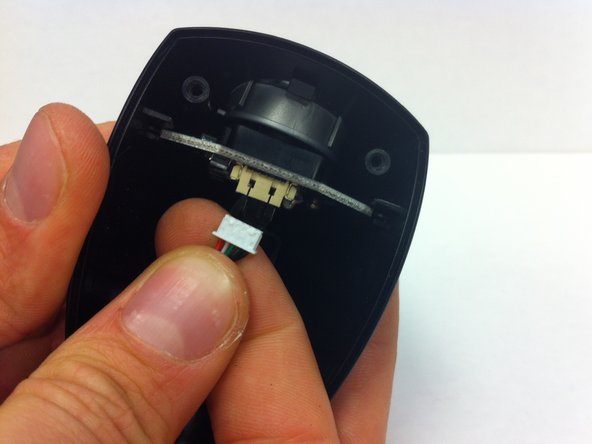

    4. Ezonics EZ-307 Main Board and USB Cable  Replacement, Remove USB Connector: crwdns2935265:04crwdnd2935265:01crwdnd2935265:03crwdne2935265:0 Ezonics EZ-307 Main Board and USB Cable  Replacement, Remove USB Connector: crwdns2935265:04crwdnd2935265:02crwdnd2935265:03crwdne2935265:0 Ezonics EZ-307 Main Board and USB Cable  Replacement, Remove USB Connector: crwdns2935265:04crwdnd2935265:03crwdnd2935265:03crwdne2935265:0

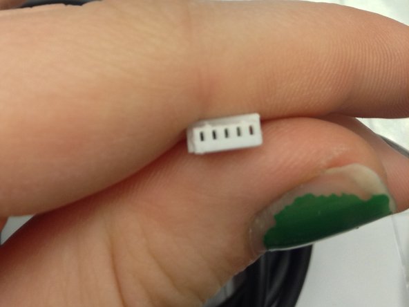

      • Gently remove the white connector with the red, green, white & black cord with your fingers. This connector is the end of the USB cable.

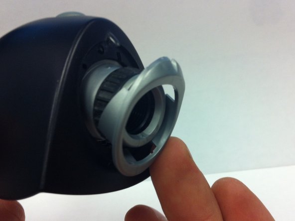

    5. Ezonics EZ-307 Main Board and USB Cable  Replacement, Remove Top Lens Casing: crwdns2935265:05crwdnd2935265:01crwdnd2935265:03crwdne2935265:0 Ezonics EZ-307 Main Board and USB Cable  Replacement, Remove Top Lens Casing: crwdns2935265:05crwdnd2935265:02crwdnd2935265:03crwdne2935265:0 Ezonics EZ-307 Main Board and USB Cable  Replacement, Remove Top Lens Casing: crwdns2935265:05crwdnd2935265:03crwdnd2935265:03crwdne2935265:0

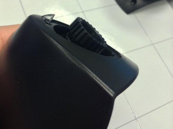

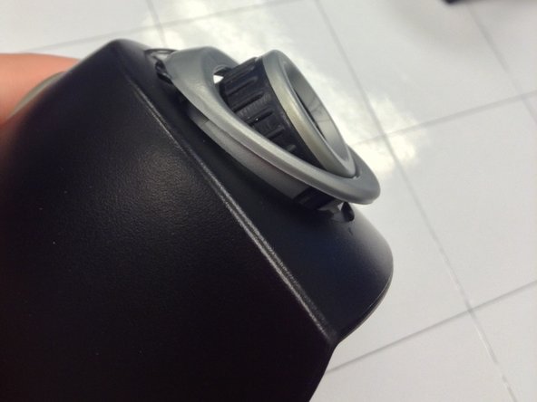

      • Press tab on inside of device to release silver ring.
      • Gently remove top (silver) ring of lens casing with your fingers.

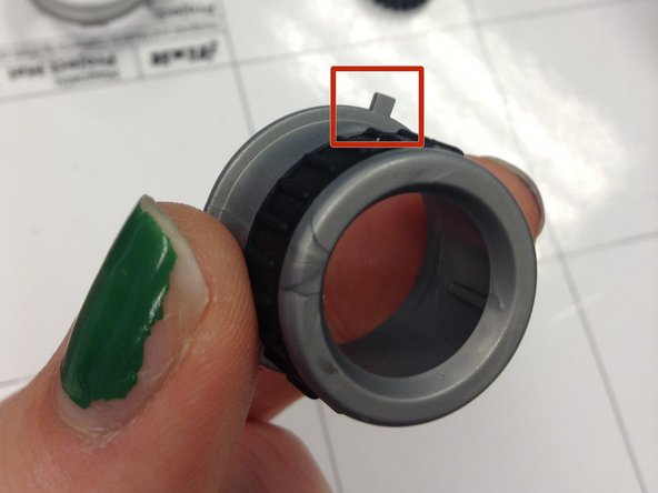

      • Gently remove inner casing of the lens (silver with a black ring).
      • Be careful not to break the small notch at the top, which holds the inner casing in place.

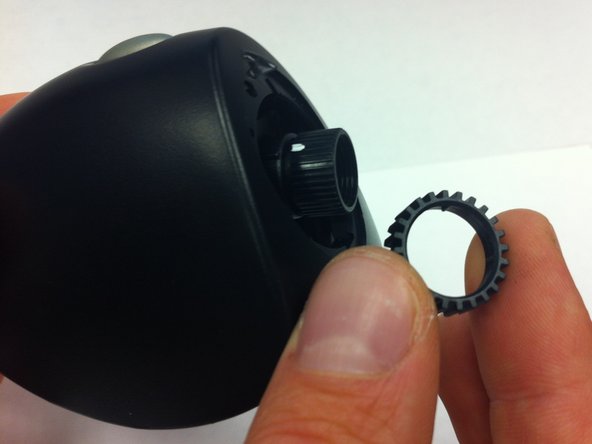

    7. Ezonics EZ-307 Main Board and USB Cable  Replacement, Remove the Inner Ring: crwdns2935265:07crwdnd2935265:01crwdnd2935265:02crwdne2935265:0 Ezonics EZ-307 Main Board and USB Cable  Replacement, Remove the Inner Ring: crwdns2935265:07crwdnd2935265:02crwdnd2935265:02crwdne2935265:0

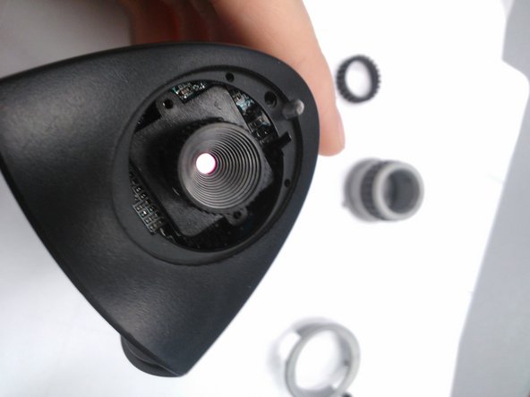

      • Remove the small, black, ridged inner ring around the lens with your fingers.
    8. Ezonics EZ-307 Main Board and USB Cable  Replacement, Unscrew the Lens: crwdns2935265:08crwdnd2935265:01crwdnd2935265:02crwdne2935265:0 Ezonics EZ-307 Main Board and USB Cable  Replacement, Unscrew the Lens: crwdns2935265:08crwdnd2935265:02crwdnd2935265:02crwdne2935265:0
      • Unscrew the lens counterclockwise with your fingers.

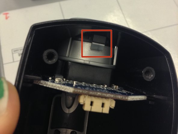

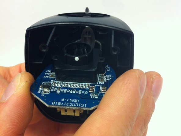

    9. Ezonics EZ-307 Main Board and USB Cable  Replacement, Carefully Remove Board From Outer Casing: crwdns2935265:09crwdnd2935265:01crwdnd2935265:02crwdne2935265:0 Ezonics EZ-307 Main Board and USB Cable  Replacement, Carefully Remove Board From Outer Casing: crwdns2935265:09crwdnd2935265:02crwdnd2935265:02crwdne2935265:0

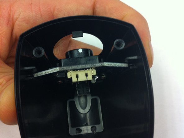

      • Turn the hollow outer casing so that you can see inside of it.
      • Gently pull out main board with fingers.
    10. Ezonics EZ-307 Main Board and USB Cable  Replacement, A New Board: crwdns2935265:010crwdnd2935265:01crwdnd2935265:02crwdne2935265:0 Ezonics EZ-307 Main Board and USB Cable  Replacement, A New Board: crwdns2935265:010crwdnd2935265:02crwdnd2935265:02crwdne2935265:0
      • Insert your new board into the outer casing. Be sure that it rests firmly between the sets of rails on either side.

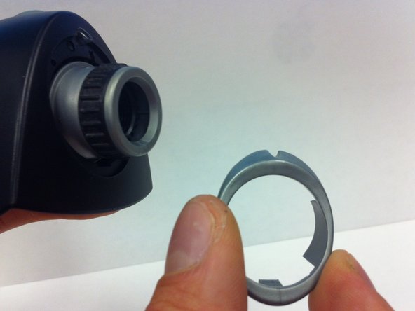

      • Line up notch on inner lens casing (silver with black ring) with notch on body of camera. Gently push it into place, being sure not to break the notch.
      • Insert the silver ring. You should hear it click into place.

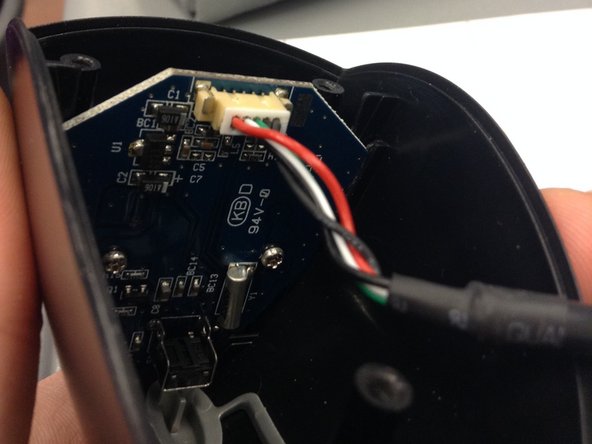

    13. Ezonics EZ-307 Main Board and USB Cable  Replacement, Insert the USB Cord: crwdns2935265:013crwdnd2935265:01crwdnd2935265:03crwdne2935265:0 Ezonics EZ-307 Main Board and USB Cable  Replacement, Insert the USB Cord: crwdns2935265:013crwdnd2935265:02crwdnd2935265:03crwdne2935265:0 Ezonics EZ-307 Main Board and USB Cable  Replacement, Insert the USB Cord: crwdns2935265:013crwdnd2935265:03crwdnd2935265:03crwdne2935265:0
      • Hold the camera in one hand with the hollow side facing up.
      • Hold the USB cable in your other hand with the four small holes facing up.
      • Plug the USB cable into the port.
