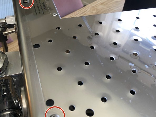

  2. Expobar Office Lever Pressurestat Replacement, Remove the housing screws: crwdns2935265:02crwdnd2935265:01crwdnd2935265:03crwdne2935265:0 Expobar Office Lever Pressurestat Replacement, Remove the housing screws: crwdns2935265:02crwdnd2935265:02crwdnd2935265:03crwdne2935265:0 Expobar Office Lever Pressurestat Replacement, Remove the housing screws: crwdns2935265:02crwdnd2935265:03crwdnd2935265:03crwdne2935265:0
    • Remove the 5 Phillips #2 screws securing the housing
    • There are two on each side of the machine and one in the rear

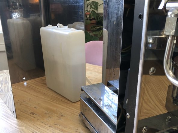

  3. Expobar Office Lever Pressurestat Replacement, Set the housing aside: crwdns2935265:03crwdnd2935265:01crwdnd2935265:02crwdne2935265:0 Expobar Office Lever Pressurestat Replacement, Set the housing aside: crwdns2935265:03crwdnd2935265:02crwdnd2935265:02crwdne2935265:0
    • Tip back the housing and set it off to the side
    • The housing is a solid 5mm sheet of steel. It weighs about 10lb / 5kg

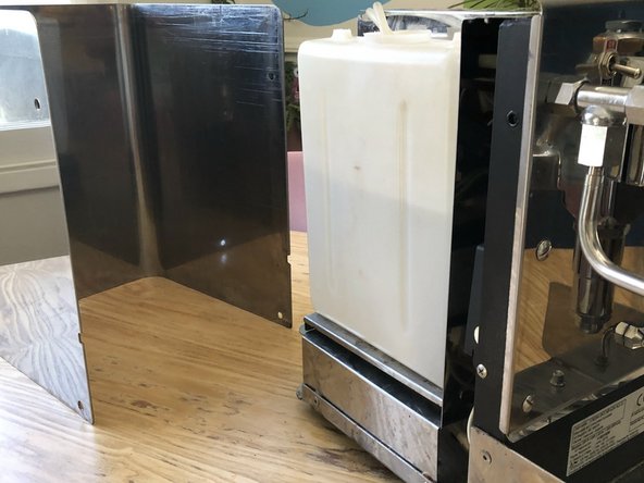

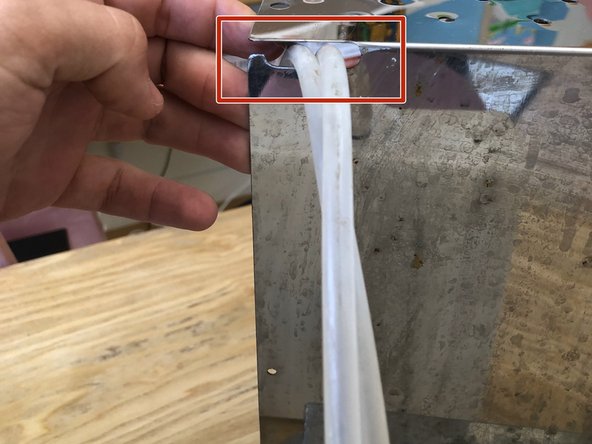

  4. Expobar Office Lever Pressurestat Replacement, Remove the water tank: crwdns2935265:04crwdnd2935265:01crwdnd2935265:03crwdne2935265:0 Expobar Office Lever Pressurestat Replacement, Remove the water tank: crwdns2935265:04crwdnd2935265:02crwdnd2935265:03crwdne2935265:0 Expobar Office Lever Pressurestat Replacement, Remove the water tank: crwdns2935265:04crwdnd2935265:03crwdnd2935265:03crwdne2935265:0
    • The water tank can be lifted off and set to the side
    • The hose line connecting to the water tank needs to be carefully slotted out of the metal sheet

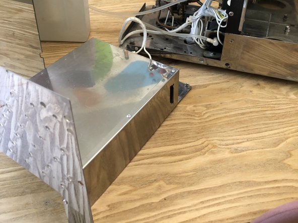

  5. Expobar Office Lever Pressurestat Replacement, Remove the Divider: crwdns2935265:05crwdnd2935265:01crwdnd2935265:03crwdne2935265:0 Expobar Office Lever Pressurestat Replacement, Remove the Divider: crwdns2935265:05crwdnd2935265:02crwdnd2935265:03crwdne2935265:0 Expobar Office Lever Pressurestat Replacement, Remove the Divider: crwdns2935265:05crwdnd2935265:03crwdnd2935265:03crwdne2935265:0
    • Remove the two Phillips #2 screws at the top of the divider
    • Remove the two Hex 3mm screws securing the bottom of the divider
    • Carefully tip the divider down
    • There will be wires connected to the water weight sensor

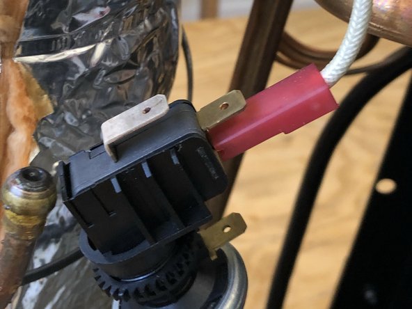

  6. Expobar Office Lever Pressurestat Replacement, Locate the pressurestat: crwdns2935265:06crwdnd2935265:01crwdnd2935265:02crwdne2935265:0 Expobar Office Lever Pressurestat Replacement, Locate the pressurestat: crwdns2935265:06crwdnd2935265:02crwdnd2935265:02crwdne2935265:0
    • The pressurestat should be covered by a small plastic clip-on protector. Remove it.
    • Note the white and red wiring connections to ensure correct installation of the new pressurestat

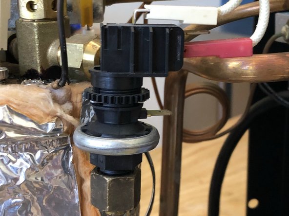

  7. Expobar Office Lever Pressurestat Replacement, Remove the pressurestat: crwdns2935265:07crwdnd2935265:01crwdnd2935265:03crwdne2935265:0 Expobar Office Lever Pressurestat Replacement, Remove the pressurestat: crwdns2935265:07crwdnd2935265:02crwdnd2935265:03crwdne2935265:0 Expobar Office Lever Pressurestat Replacement, Remove the pressurestat: crwdns2935265:07crwdnd2935265:03crwdnd2935265:03crwdne2935265:0
    • Use two crescent wrenches to remove the pressure stats. The bottom nut will unscrew while the top is used for grip.

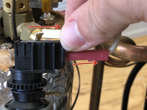

    • Remove the wire connections by sliding them carefully away from the pressurestat
