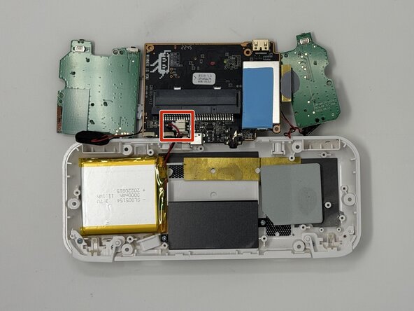

    • The battery is wired to the motherboard via a connector inserted into a socket.
    • Flip the motherboard to the outside of the console.
    • The side boards are connected to the center board by a ribbon cable and a soldered wire, when removing the entire motherboard, keep them connected.
    • Remove the connector from the socket attached to the motherboard. The piece is held in place near the back of the socket. Apply downward pressure while pulling out to make the removal easier.
    • When removing the connector, it may require a significant amount of force. If too much force is applied, the plastic connector may compress or snap.
