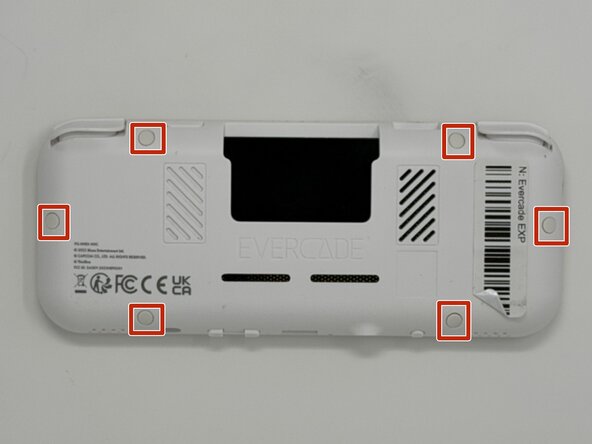

      • Lay the device on a flat surface, with the screen facing the sufrace.
      • Using angled tweezers, remove the six rubber screw covers from the sockets.
      • The covers are all identical, so they do not need to be stored separately from one another.

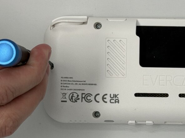

    2. Evercade EXP Buttons Replacement: crwdns2935265:02crwdnd2935265:01crwdnd2935265:03crwdne2935265:0 Evercade EXP Buttons Replacement: crwdns2935265:02crwdnd2935265:02crwdnd2935265:03crwdne2935265:0 Evercade EXP Buttons Replacement: crwdns2935265:02crwdnd2935265:03crwdnd2935265:03crwdne2935265:0
      • Using a Phillips #00 screwdriver, remove the six 8 mm screws on the lower case.
