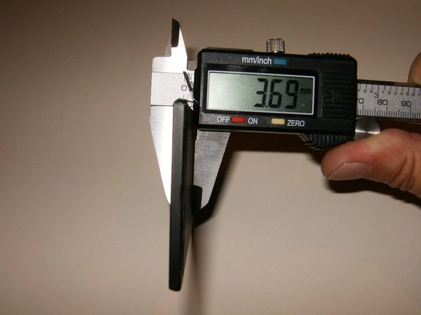

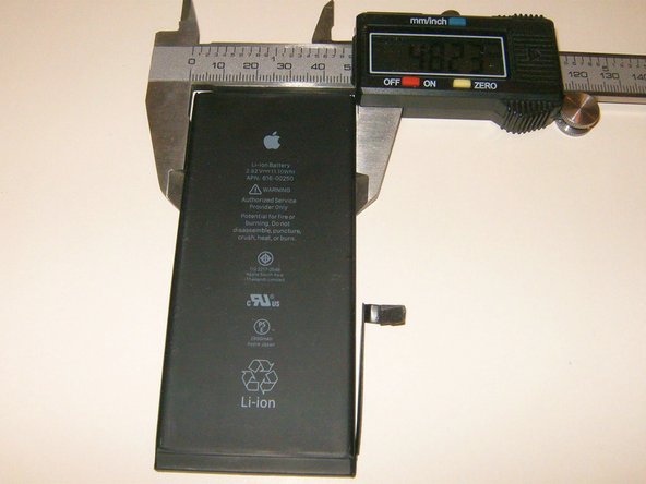

    • Next we have the eBay battery. Weight is 44.02 gram
  3. Evaluating High Capacity Batteries (Part II): crwdns2935265:03crwdnd2935265:01crwdnd2935265:03crwdne2935265:0 Evaluating High Capacity Batteries (Part II): crwdns2935265:03crwdnd2935265:02crwdnd2935265:03crwdne2935265:0 Evaluating High Capacity Batteries (Part II): crwdns2935265:03crwdnd2935265:03crwdnd2935265:03crwdne2935265:0
    • Length is 108.9mm
    • Width is 48.32
    • and a thickness of 3.69mm

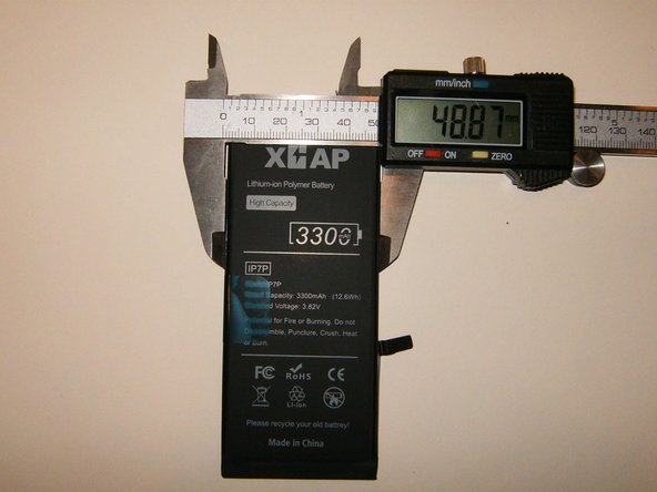

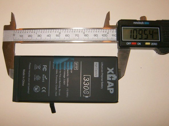

    • Now the XCAP battery. Weight is 45.86gram
    • length is 109.54mm and width is 48.87mm.
  5. Evaluating High Capacity Batteries (Part II): crwdns2935265:05crwdnd2935265:01crwdnd2935265:03crwdne2935265:0 Evaluating High Capacity Batteries (Part II): crwdns2935265:05crwdnd2935265:02crwdnd2935265:03crwdne2935265:0 Evaluating High Capacity Batteries (Part II): crwdns2935265:05crwdnd2935265:03crwdnd2935265:03crwdne2935265:0
    • Thickness of the XCAP is 3.62mm
    • Yes, it is boring and tedious but to ensure that this guide compares like to like it is felt to be necessary.

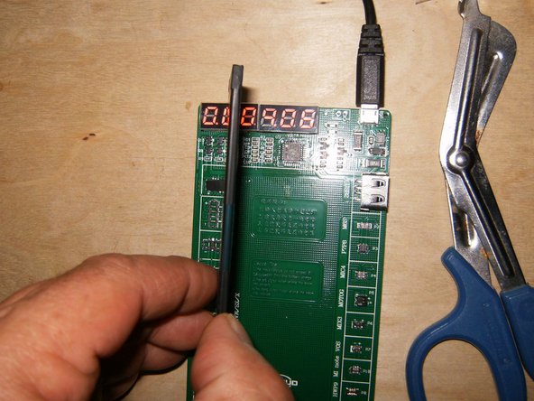

    • For the question on Answers, the batteries were all charged using a “Fast Charging Activation Test Fixture” by Jageud.During those tests the board only managed to charge all three batteries to around 4.09Volt.

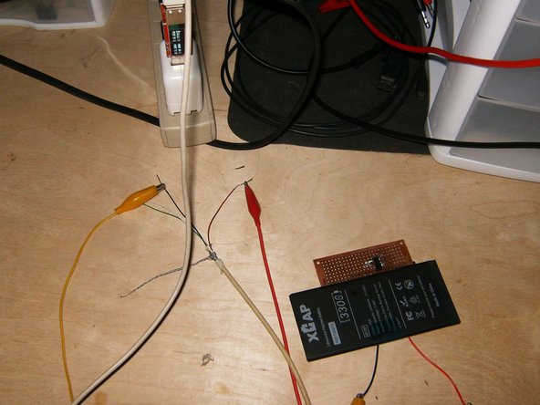

    • I did not want to use my lab power supply but wanted to stay with equipment that others may have available as well. As a tinkerer by heart, I opted for an Apple charger as well as an Apple charge cable. I hacked the original 30 pin connector off and determine + and - wires
    • I then connected the positive to positive and negative to negative directly to the prototype board, bypassing any communication etc. from the battery to the charger. Charging was monitored with a USB ammeter. All batteries were charged this way to around 4.24V. It is possible that this is where the battery protection prevents overcharging.

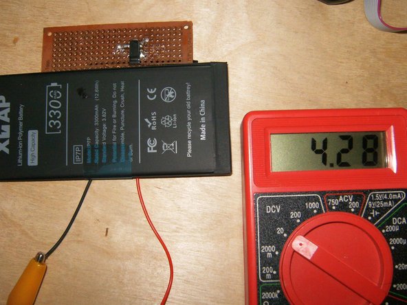

    • Once the ammeter showed that the batteries were no longer accepting a charge, the batteries were checked with a run-of the mill multimeter.
    • eBay battery charged to 4.29V
    • iFixit 4.39V (anomaly)
    • XCAP batter 4.28 V
