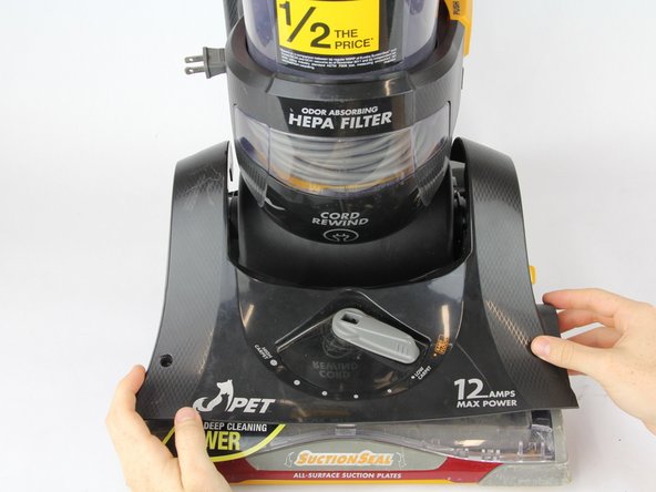

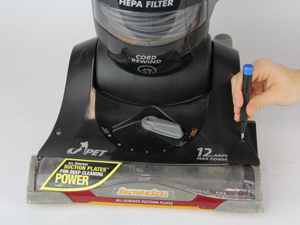

    • Remove the four 19 mm screws using a Phillips #2 screwdriver.
    • Remove the vacuum head cover by lifting away from the vacuum head.

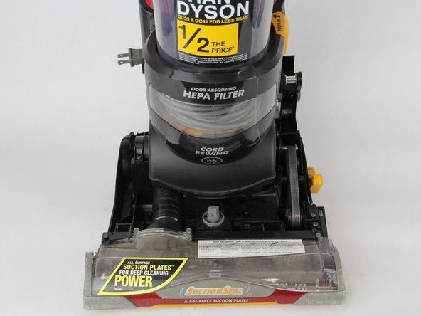

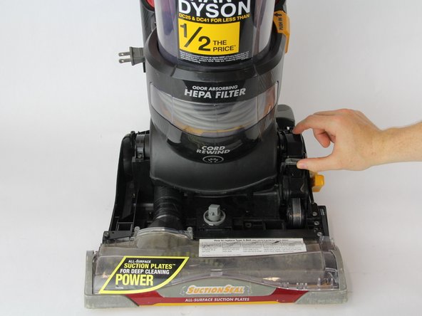

  2. Eureka SuctionSeal Pet S Belt Replacement: crwdns2935265:02crwdnd2935265:01crwdnd2935265:03crwdne2935265:0 Eureka SuctionSeal Pet S Belt Replacement: crwdns2935265:02crwdnd2935265:02crwdnd2935265:03crwdne2935265:0 Eureka SuctionSeal Pet S Belt Replacement: crwdns2935265:02crwdnd2935265:03crwdnd2935265:03crwdne2935265:0
    • Lift up the tab on the S Belt cover.

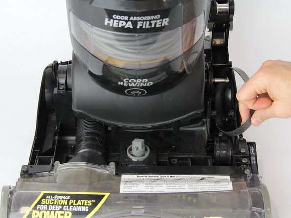

  3. Eureka SuctionSeal Pet S Belt Replacement: crwdns2935265:03crwdnd2935265:01crwdnd2935265:02crwdne2935265:0 Eureka SuctionSeal Pet S Belt Replacement: crwdns2935265:03crwdnd2935265:02crwdnd2935265:02crwdne2935265:0
    • Starting from the bottom of the S belt, rotate the S belt away from the wheel.
    • Lift the S belt away from the bottom roller and remove from the motor shaft by sliding the S belt between the motor shaft and the vacuum head wall.
