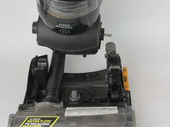

    • Remove the four 19 mm screws using a Phillips #2 screwdriver.
    • Remove the vacuum head cover by lifting away from the vacuum head.
  2. Eureka SuctionSeal Pet Drive Motor Replacement: crwdns2935265:02crwdnd2935265:01crwdnd2935265:03crwdne2935265:0 Eureka SuctionSeal Pet Drive Motor Replacement: crwdns2935265:02crwdnd2935265:02crwdnd2935265:03crwdne2935265:0 Eureka SuctionSeal Pet Drive Motor Replacement: crwdns2935265:02crwdnd2935265:03crwdnd2935265:03crwdne2935265:0
    • Lift up the tab on the S Belt cover.
  3. Eureka SuctionSeal Pet Drive Motor Replacement: crwdns2935265:03crwdnd2935265:01crwdnd2935265:02crwdne2935265:0 Eureka SuctionSeal Pet Drive Motor Replacement: crwdns2935265:03crwdnd2935265:02crwdnd2935265:02crwdne2935265:0
    • Starting from the bottom of the S belt, rotate the S belt away from the wheel.
    • Lift the S belt away from the bottom roller and remove from the motor shaft by sliding the S belt between the motor shaft and the vacuum head wall.

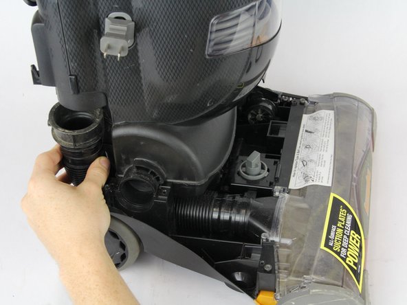

  4. Eureka SuctionSeal Pet Drive Motor Replacement, Drive Motor: crwdns2935265:04crwdnd2935265:01crwdnd2935265:03crwdne2935265:0 Eureka SuctionSeal Pet Drive Motor Replacement, Drive Motor: crwdns2935265:04crwdnd2935265:02crwdnd2935265:03crwdne2935265:0 Eureka SuctionSeal Pet Drive Motor Replacement, Drive Motor: crwdns2935265:04crwdnd2935265:03crwdnd2935265:03crwdne2935265:0
    • Remove two 19 mm screws using a Torx T20 screwdriver.
    • Remove the vacuum head retaining bracket.
    • Pull down on the vacuum hose to remove the hose from the body.
    • Lift the vacuum body away from the vacuum head to separate.

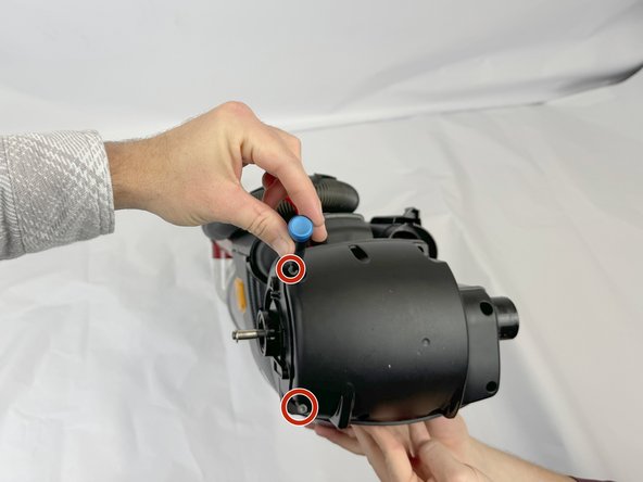

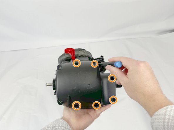

  5. Eureka SuctionSeal Pet Drive Motor Replacement: crwdns2935265:05crwdnd2935265:01crwdnd2935265:03crwdne2935265:0 Eureka SuctionSeal Pet Drive Motor Replacement: crwdns2935265:05crwdnd2935265:02crwdnd2935265:03crwdne2935265:0 Eureka SuctionSeal Pet Drive Motor Replacement: crwdns2935265:05crwdnd2935265:03crwdnd2935265:03crwdne2935265:0
    • Remove two 28 mm screws holding the motor cover retaining bracket using a Torx T20 screwdriver.
    • Remove the remaining six 19 mm screws using a Torx T20 screwdriver.
    • The two outer 19 mm screws are set deeper in the cover than the rest and may require an extension to remove.

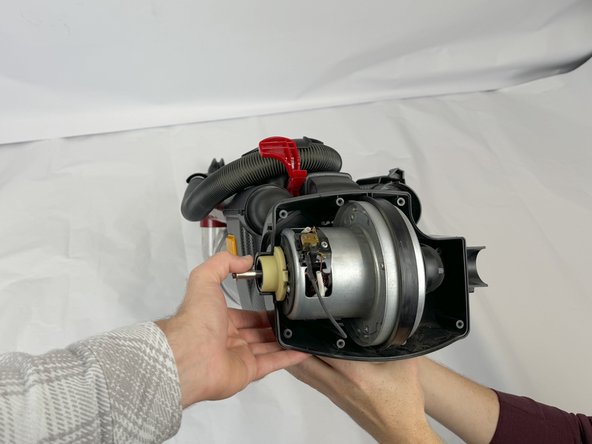

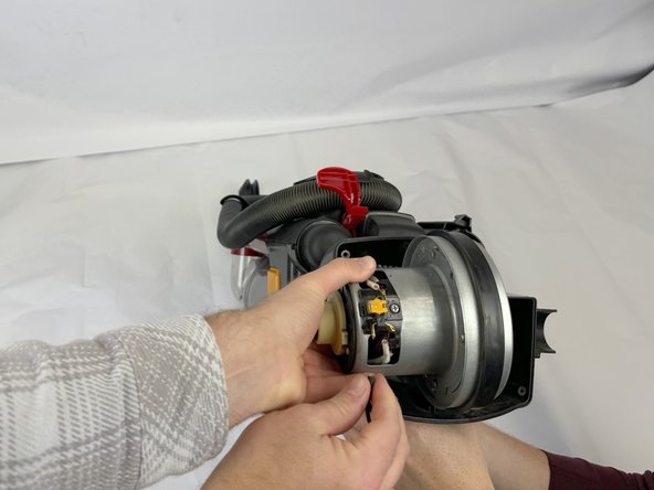

  6. Eureka SuctionSeal Pet Drive Motor Replacement: crwdns2935265:06crwdnd2935265:01crwdnd2935265:02crwdne2935265:0 Eureka SuctionSeal Pet Drive Motor Replacement: crwdns2935265:06crwdnd2935265:02crwdnd2935265:02crwdne2935265:0
    • Remove the motor case cover to expose the drive motor.

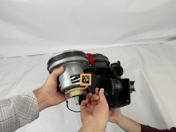

  7. Eureka SuctionSeal Pet Drive Motor Replacement: crwdns2935265:07crwdnd2935265:01crwdnd2935265:03crwdne2935265:0 Eureka SuctionSeal Pet Drive Motor Replacement: crwdns2935265:07crwdnd2935265:02crwdnd2935265:03crwdne2935265:0 Eureka SuctionSeal Pet Drive Motor Replacement: crwdns2935265:07crwdnd2935265:03crwdnd2935265:03crwdne2935265:0
    • Make sure the vacuum is unplugged before touching any electric components.
    • Remove the electric clip attaching the power to the motor.
    • Remove a second identical electric clip from the motor on the back side of the motor.
