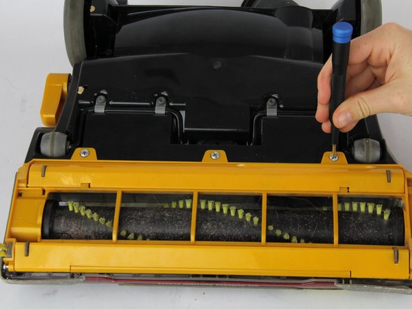

    • Remove the three 19 mm screws on the bottom of the head with a Phillips #2 screw driver.
    • Pull on the yellow sole plate to remove.

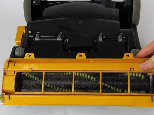

  2. Eureka SuctionSeal Pet Brush Roller Replacement: crwdns2935265:02crwdnd2935265:01crwdnd2935265:01crwdne2935265:0
    • Remove the brush roller by pulling the right side of the roller up and out.
