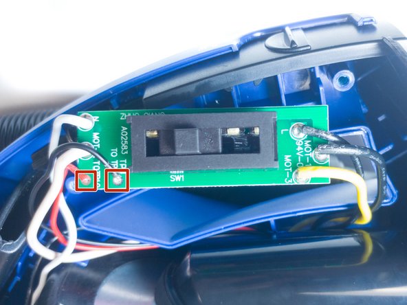

  7. Eureka EasyClean 71C Motor Replacement, Motor: crwdns2935265:07crwdnd2935265:01crwdnd2935265:01crwdne2935265:0
    • Pull out the switch board.
    • Ensure the vacuum is turned off and unplugged before handling any of the electronics.
  8. Eureka EasyClean 71C Motor Replacement: crwdns2935265:08crwdnd2935265:01crwdnd2935265:02crwdne2935265:0 Eureka EasyClean 71C Motor Replacement: crwdns2935265:08crwdnd2935265:02crwdnd2935265:02crwdne2935265:0
    • Desolder the pictured red and black wires.
    • For instructions on how to solder and desolder wires, visit this guide.
