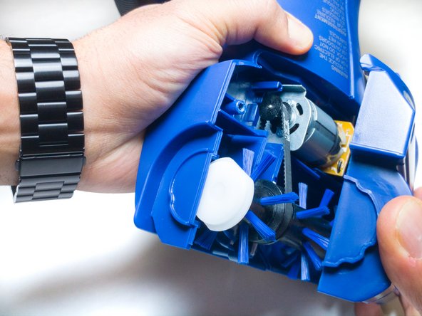

  4. Eureka EasyClean 71C Brush Roller Replacement: crwdns2935265:04crwdnd2935265:01crwdnd2935265:02crwdne2935265:0 Eureka EasyClean 71C Brush Roller Replacement: crwdns2935265:04crwdnd2935265:02crwdnd2935265:02crwdne2935265:0
    • Unscrew the 14mm PH2 Phillips head screw.
    • Pull the bottom cover off of the rest of the casing.

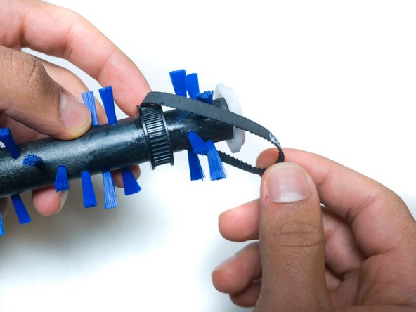

  5. Eureka EasyClean 71C Brush Roller Replacement, Roller: crwdns2935265:05crwdnd2935265:01crwdnd2935265:02crwdne2935265:0 Eureka EasyClean 71C Brush Roller Replacement, Roller: crwdns2935265:05crwdnd2935265:02crwdnd2935265:02crwdne2935265:0
    • Pull the roller, motor, and belt out of the casing.
    • Separate the roller from the belt.
