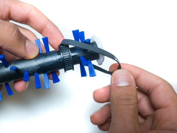

  5. Eureka EasyClean 71C Belt Replacement, Belt: crwdns2935265:05crwdnd2935265:01crwdnd2935265:02crwdne2935265:0 Eureka EasyClean 71C Belt Replacement, Belt: crwdns2935265:05crwdnd2935265:02crwdnd2935265:02crwdne2935265:0
    • Pull the roller, motor, and belt out of the casing.
    • Separate the belt from both the roller and the motor.
