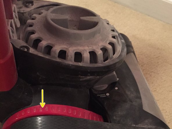

  6. Eureka Airspeed Exact Pet Bagless Upright Vacuum Power Switch Replacement, Remove black brush and belt housing: crwdns2935265:06crwdnd2935265:01crwdnd2935265:01crwdne2935265:0
    • At this point I did not find any more fasteners to remove and sort of jockeyed the black brush and belt housing around by pulling it outward from one side.
    • I noticed that there was a "keyed" fit between the housing and the frame. By rotating the housing and holding the frame steady I was able to carefully but firmly free one side of the housing and pull it away from the frame. Once one side was removed, the other side could be easily taken out and the whole housing removed.
    • Unfortunately, I don't have a good photo of this process.
  7. Eureka Airspeed Exact Pet Bagless Upright Vacuum Power Switch Replacement, Remove red wheel frame: crwdns2935265:07crwdnd2935265:01crwdnd2935265:02crwdne2935265:0 Eureka Airspeed Exact Pet Bagless Upright Vacuum Power Switch Replacement, Remove red wheel frame: crwdns2935265:07crwdnd2935265:02crwdnd2935265:02crwdne2935265:0
    • After the brush and belt housing is removed, the red wheel frame can be removed in a similar fashion.
    • The first photo is from the bottom just to show how the wheel frame is wrapped around the black motor housing.
    • Carefully but firmly pull outwards on one of the wheel frame ends to free it from the motor housing and then remove the whole red wheel frame.

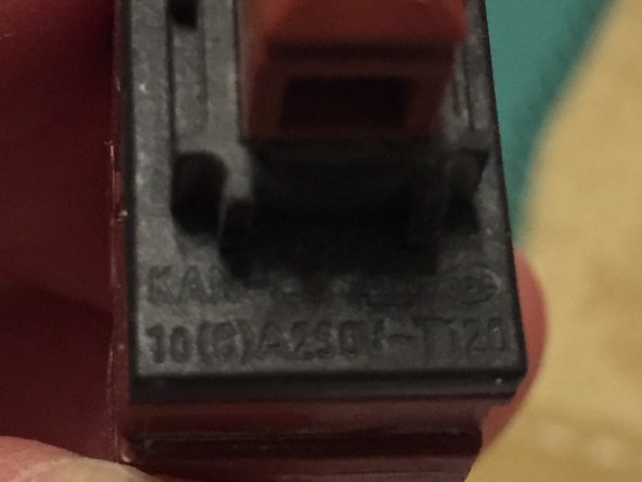

  11. Eureka Airspeed Exact Pet Bagless Upright Vacuum Power Switch Replacement, Replace (or possibly repair) switch: crwdns2935265:011crwdnd2935265:01crwdnd2935265:03crwdne2935265:0 Eureka Airspeed Exact Pet Bagless Upright Vacuum Power Switch Replacement, Replace (or possibly repair) switch: crwdns2935265:011crwdnd2935265:02crwdnd2935265:03crwdne2935265:0 Eureka Airspeed Exact Pet Bagless Upright Vacuum Power Switch Replacement, Replace (or possibly repair) switch: crwdns2935265:011crwdnd2935265:03crwdnd2935265:03crwdne2935265:0
    • With the switch removed, the make and model are identified. The switch is a NOVA KAN-L5 SPST pushbutton switch. This appears to be an imported component from China. I could not find much documentation on the internal details.
    • Further research indicates the Eureka / Electrolux OEM part is #81142-1. Repair Clinic, an online retailer, shows that their replacement switch is a "Defond CPU-1113"
    • At my house, every cleaning appliance (vacuum, clothes washer, clothes dryer, etc.) is critical and must be in working order 24 x 7 or my spouse will go out and quickly purchase a new working replacement...therefore I was under pressure to perform a repair or get out the wallet.
    • It's not often that I've noticed 120VAC switches with removable components so I was intrigued to see the plastic tabs on each side of this switch.

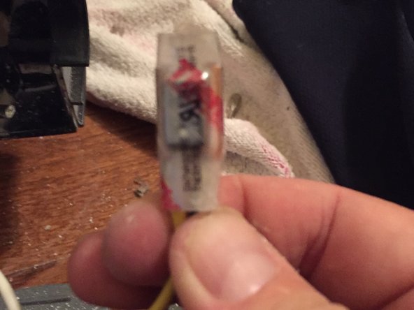

  12. crwdns2935267:0crwdne2935267:0
    • Using my iFixit tweezers I carefully lifted the black tabs of the switch and the top half of the switch could be lifted off.
    • The switch contained two springs and a small copper pole. Upon inspection, when the switch was pressed, the main spring compressed and held the switch pole down, but the pole was not making contact with the "throw" (one of the spade connectors).
    • It appeared that the pole might have been bent slightly from its original orientation. My fix was to slightly bend the pole to ensure that it would make contact with the spade connector as designed.

Awesome post with great instructions and illustrative photos. Thank you. I had disassembled this unit to the point of the wheel housing and like you could not find any more fasteners. Following your lead I was able to finagle the motor housing rotation position and the wheel housing to get the tabs aligned with the slots and spread the wheel housing to clear the motor housing. For my unit, the switch was not making contact and I found a fair amount of oxides on the switch contacts. Cleaning the oxides off restored continuity to the switch. I did not need to bend the armature of the switch (see-saw if you will). Even though it is working fine now, I will order a replacement switch to make sure this one will never fail again. ;-)
